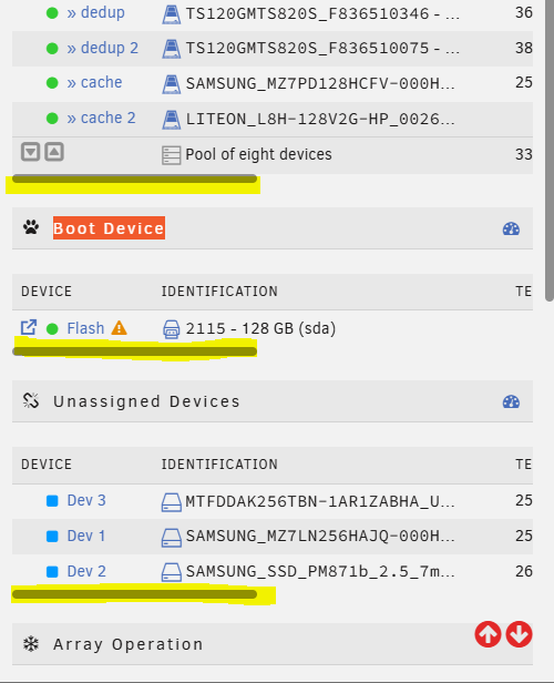

November 4, 2025Nov 4 Just upgraded to 7.2.0 and the UI on mobile edge browser is off, the side bar stays static and the center of the page it’s scrollable but not completely. This is a new issue I’ve never had an issue before with the way the page moves. Tried clearing cache etc. but still same result. On mobile only. It’s as if the webpage is being treated like each is a separate section with the static left menu.ScreenRecording_11-04-2025 14-08-41_1.mov Edited November 4, 2025Nov 4 by Fiservedpi
November 5, 2025Nov 5 Community Expert Looking at the video not sure what the issue is, you are using the azure theme, with that theme the settings bar is on the left side, it won't move, with the white and black themes, the bar is a the top.
November 5, 2025Nov 5 Author The left bar isn’t the issue it’s the data in the middle that doesn’t scroll, they scroll like individuals cards which is to cumbersomeArray scrollable card left and rightPool scrollable card left and rightSo on n so forthAs opposed the page scrolling as one unit like usual Edited November 5, 2025Nov 5 by Fiservedpi
November 5, 2025Nov 5 Community Expert If you mean each section from main scrolling individually, this is expected, each one has a scroll bar.:
November 5, 2025Nov 5 Author Hmmm I’ve never had this before 7.2 I can’t get the scroll bar on the right to move the whole page up n down. Probably related to my set up. Thanks for showing me this.
November 5, 2025Nov 5 Community Expert Solution 3 minutes ago, Fiservedpi said:Hmmm I’ve never had this before 7.2Before the browser wasn't responsive, there were many changes from 7.1 to try and make it so, though there are some constraints because of the existing architecture. This should be much improved once the GUI is redesigned based on the API, which is expected soon, but AFAIK there is no definitive ETA yet.
