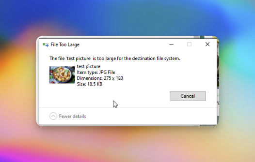

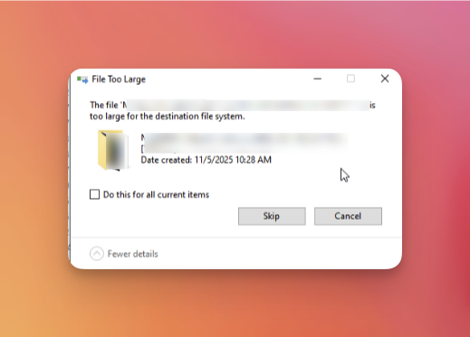

November 6, 2025Nov 6 HelloAfter updating to Unraid v7.2 (stable), file transfers from my Windows 10 VM (running on Proxmox) to the Unraid server consistently fail with an error, regardless of file size. This issue did not occur on previous Unraid releases.Interestingly, the transfer succeeded once immediately after restarting the Windows VM, even for files exceeding 4 GB. Subsequent attempts reproduced the error.Has anyone else encountered this behavior on v7.2?This file is 4.2GBThis file is 18.5KB
