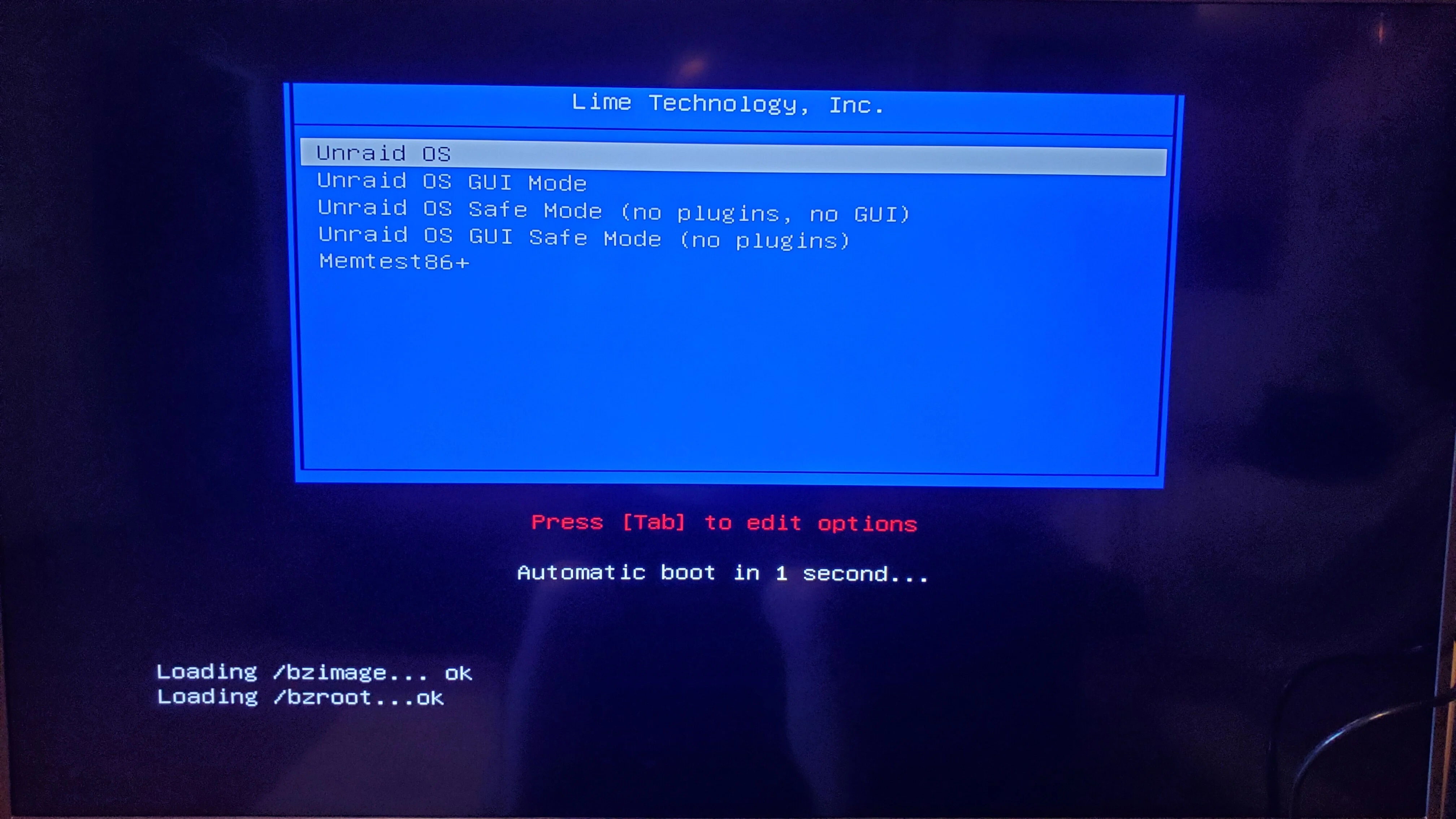

I use Unraid as a Plex server. I was running on an old Dell Optiplex, everything worked great other then the Optiplex being old and showing it's age. I’ve now built a new system and it’s been nothing but issues so far.

I restarted the PC and, ever since, I haven’t been able to get Unraid to boot. It just hangs at the boot menu and goes nowhere.

I'm at work right not so the attached image isn't mine but it's exatcly the point mine freezes at, I never get past this.

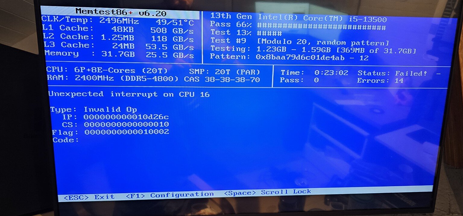

Memtest?
I've not done one - I'll give it a go tonight, after trying a seperate USB, and report back with results.
Edited by Gary-W
So i've done the mem test. After about 20 mins it stopped with 14 erros and 'Unexpected interrupt on CPU 16'.
I then tried runnig again but only on CPU 16 and it froze up around 6-8 seconds. Tried a few times to the same result everytime.
I take it this is a CPU issue and I should get a replacement?
Most likely. You have a 13th gen Intel CPU which is notorious (as well as 14th gen.) for having stability issues.
