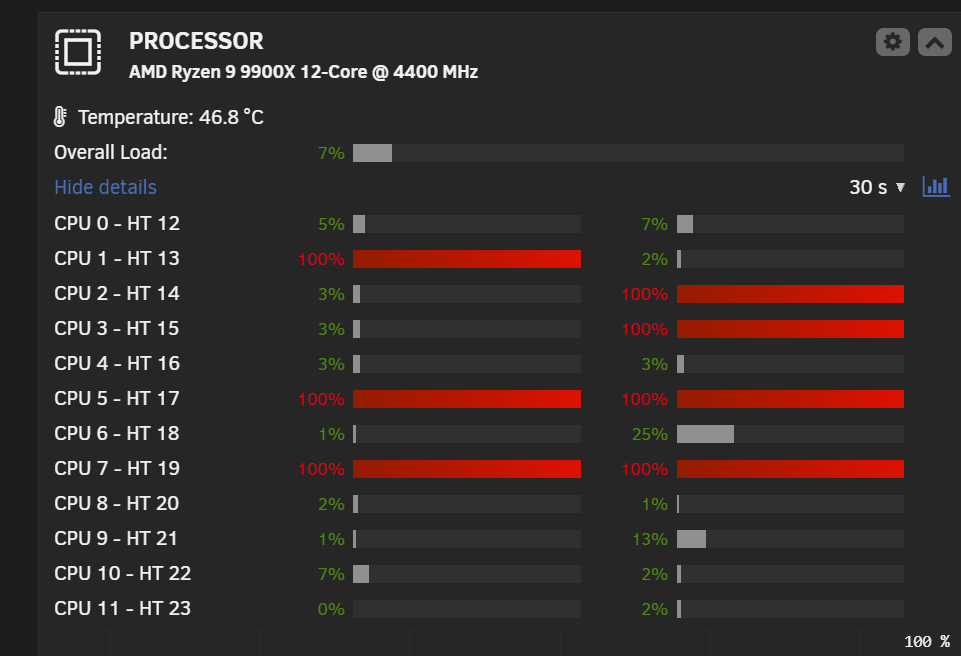

Hello Everyone,
I've a recurrent problem since using Unraid (I started like 5years ago).
As soon as some of the CPUs hits 100% (mostly due to either unzipping or SMB transfer), the whole server freezes:
I don't know if I've missed some setting.
Is also strange that only a couple of cores are so busy when extracting a .rar/.zip for example (which normally happens trough a Docker container / JDownloader)
Any advice is appreciated.

On 11/7/2025 at 7:44 AM, JorgeB said:
Does it recover after the transfer ends?
On 11/18/2025 at 8:42 AM, JorgeB said:
Yes.
I've seen over the years some users with similar issues. It's unclear why only some are affected, test writing to a disk share (or exclusive share) to see if it helps, it usually does, if you can make that work for your use case.
