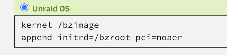

I'd first reseat your AsMedia HBA. If that doesn't fix it then from Main, Boot Device, Click on Flash then Syslinux configuration then on whatever section has the radio button selected, add in pci=noaer as shown below to the end of the append linedwaq
I recommend first trying to try use pcie_aspm=off to see if it that stops the errors, if that doesn't work, then try pci=noaer, that should at least suppress them
