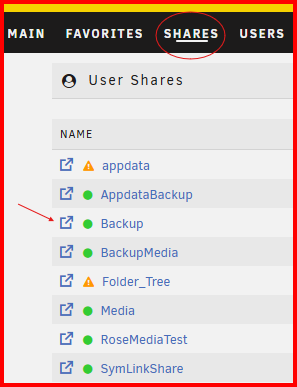

There is a built-in File manager in all recent versions of Unraid. I would suggest using that to see what shares are files are on your server. Click on the indicated icon to explore at the disk level:
image.png and at this location for the Share view:image.png
