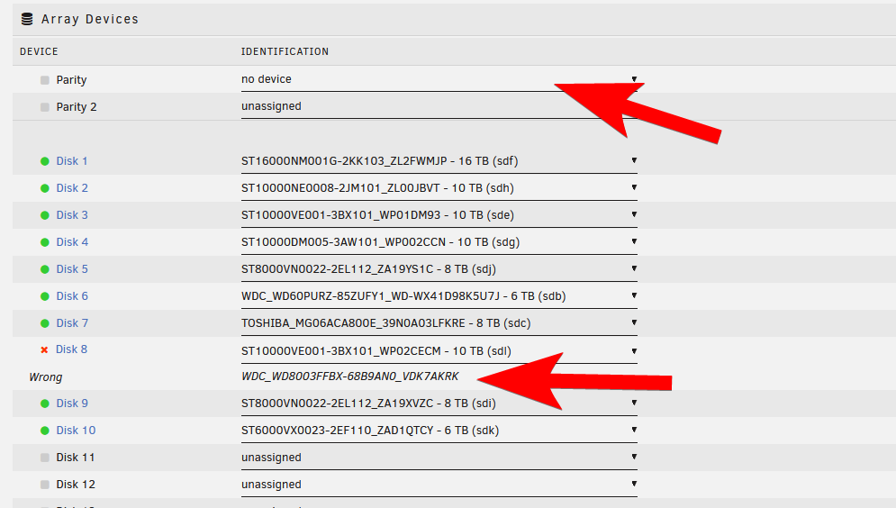

Hi @JorgeB I did some testing and it seems like Drive 8 has failed. When I plug it in and run the server, it does not spin up at all. I have felt it and listened to it.
I think that it may have died. If that is the case. How can I start up my array as, with both the parity drive and drive 8 down, I am not able to start it up.
OK I did some further testing, I plugged Disk 8 into an external enclosure and it failed to spin up and even be recognized by Unraid. Whereas, when I plugged in the parity drive, it was picked up and spun up.
This confirms that the drive IS dead.
Apologies, I know that this is a very similar message to what I sent an hour ago, but it is confirmation.
My problem is now, how can I replace the DISK 8 and then get the parity to rebuild itself

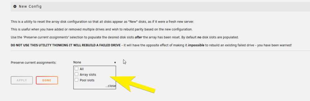

You can do a new config (Tools - New config) to be able to start the array with the remaining drives, but note that any data that was on disk8 will be lost.
Which one of the above must I choose?
Keep all

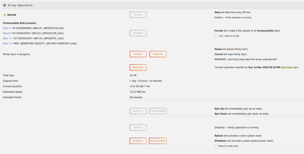

Nearly DOne! Crossing fingers that everything will sort it self out when the parity is done
There are a lot of disk errors shown, there are still issues, and also unmountable disks. Post new diags, please.

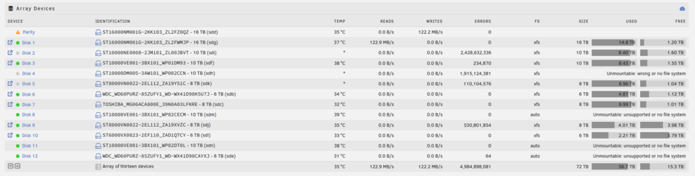

So the parity check finished and then I formatted the 3 new drives and then mounted them. Everything is looking good.
Is there anything that I need to be worried about from the previous post? Disk4 is a drive that was previously in the array and Disks 8, 11 and 12 are the new ones.
I added diagnostics for clarity.
datavault972-diagnostics-20251216-1103.zip
Yes, all the disk errors are happening with multiple disks:
