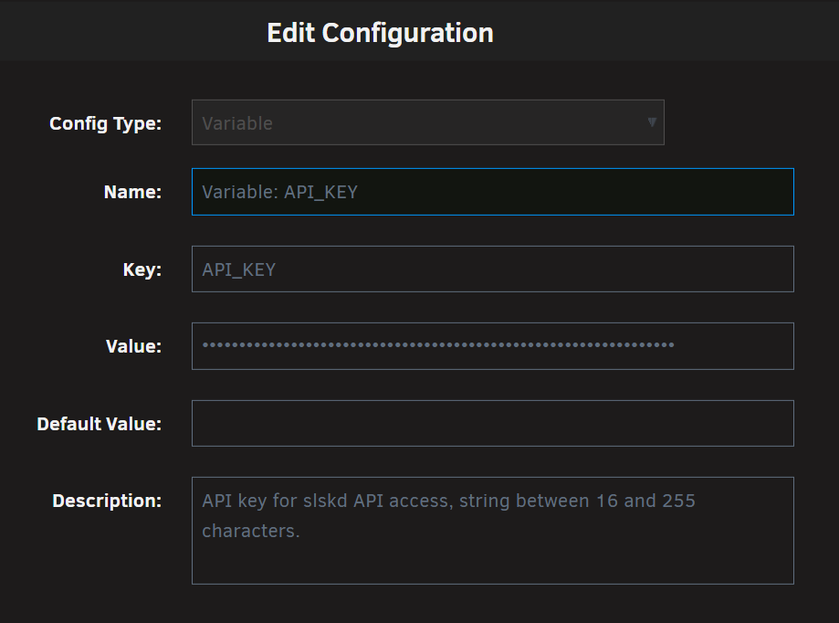

Would you please document anywhere (inside the Unraid Docker Template Overview / Port: HTTP Web Interface / ...) that the API port for binhex-slsk is 8980 and different from the original slskd container where it is port 5030?
I was trying to connect LazyLibrarian with binhex-slsk and couldn't figure this out 😅
Also please add the Varible SLSKD_API_KEY with a note to generate an API key with openssl rand -hex 16 on the any Linux machine )
Many thanks!
Is there a begginers guide or "how to" on setting up API keys?
I want to setup Soularr but need an api key, and everything I've found on how to do it is pretty vague. Thanks!
OK so i have made some strides to make this easier, the slskd CA template now includes a new 'variable' named 'API_KEY', but as CA Templates do not auto update you wil have to add it in if you are using the template before this change, here is what it should look like:
So the actual API_KEY can be anything, as long as its between 16 and 255 characters, if you want to follow the slskd guide then they suggest you run the following command inside the slskd container to generate a randomised string (left click icon, choose console) then execute openssl rand -hex 16then copy and paste the strng into the value field for the API_KEY.
Once this is set apply the change (bottom button on the edit screen) and then set the 'variable' SLSKD_API_KEY in soularr to match and you should be good, pretty simply really.

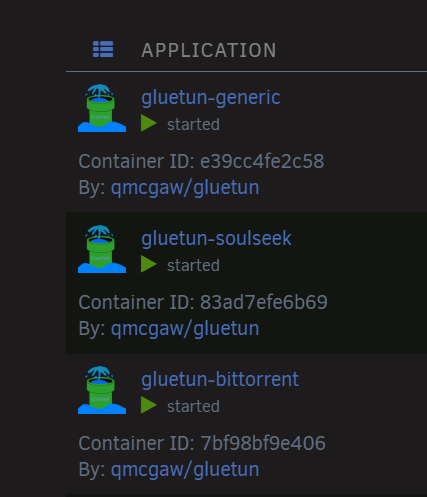

I've been trying to set this up for the past few days and I'm kind of at a loss, I'll explain where I'm at:
I have the Gluetun container, it's working with protonvpn over wireguard - all good. I'm using it with download clients (Deluge) without any issue, also threw some other stuff behind there as well using the container network of Gluetun - everything's great. However....
Soulseek I can't get going. I think it's something to do with the script for updating the gluetun port.
If Soulseek isn't connected to the container network, the webgui is reachable on 8980 and 8990
If Soulseek IS connected to the Gluetun container network but Gluetun updating the incoming port is set to NO and 8980 and 8990 are exposed on the Gluetun container = GUI Reachable.
If Soulseek IS connected to the Gluetun container network and Gluetun updating the incoming port is set to YES and 8980 and 8990 are exposed on the Gluetun container = GUI Unreachable.
I have no idea what's going on in the backend causing Gluetun to just... stop working. Deluge updates just fine using the methodology and everything is reachable.
Thanks again for all your efforts.
First thought, are you trying to run slskd inside of the same gluetun container network as deluge?, if so that will not work, you cannot have multiple applications sharing a single incoming port, instead you will need to create another glutun container specifically for slskd, i do exactly this, this is what i currently have setup:
So as you can see i have three containers running,
  • gluetun-generic - for all the containers that do not require an incoming port, which is the vast majority of containers, e.g. sonarr, radarr, jackett, prowlarr, etc
  • gluetun-soulseek - as the name inplies this is specifically for soulseek containers, such as nicotine+ and slskd, do note though again you cannot run both nicotine+ and slskd in the same gluetun container network
  • gluetun-bittorrent - again im pretty sure you can guess what this is used for, again i can only run a single bittorrent client in this gluetun container network, running deluge and qbittorrent would not wok.
The golden rule - You need 1 gluetun container for each application that requires an incoming port.
p.s. I could slim this down to just two, bittorrent and soulseek and lump the containers that only require outbound (generic) into either one, but i prefer the separation and PIA are relatively generous with their concurrent connections.
What i suspect is happening is slskd is crashing/hanging due to the previous issue i just posted, thus when the incoming port is assigned to slskd and deluge is also using the same port then slskd crashes.
This is going to be exactly my problem. For some reason I got all caught up in the Gluetun setup I completely overlooked 1 app 1 port and basic networking left my brain. Ironically my next stop when I got in front of the server again tonight was going to be changing the start order to deluge second to see what happened.
