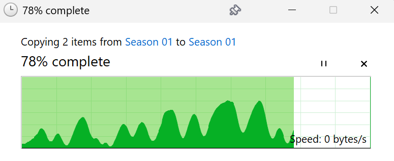

I've been using Unraid for five years now, and I've always experienced slower transfer speeds and video buffering, but it seems more common lately, and I'm trying to find a solution. I've read that not maintaining 15% +/- free space on HDDs can cause bandwidth issues, and I usually keep mine pretty full, with only 100GB +/- free. Any time I transfer files to or from my Unraid server to my PC, I get the sawtooth pattern, which reaches speeds of up to 80 Mbps or less and then drops back down to 0 Mbps, repeating over and over. I've had this issue with multiple PCs and networking equipment, so if it's a hardware issue, it would likely be limited to the Unraid server hardware.
I've attached my diagnostics. Are my drives too full, causing this issue, or is it something else?

Based on the screenshot, you appear to be copying from the array to the array, or is this over SMB?

This is a screenshot from my PC, transferring files from the array to my PC via a network share.

That screenshot shows me moving a TV show to my PC from the array so that I can watch the file locally, avoiding lag.
