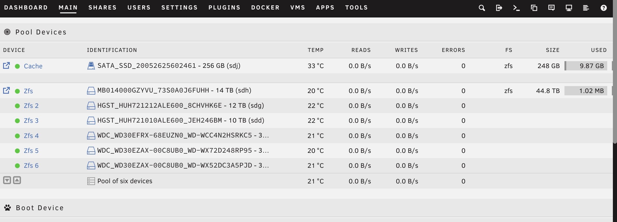

My ZFS pool had around 4gb of data on it, and it was a RAID Z2 config. Now it has no data on it.
Come to think of it, my cache pool was a mirrored ZFS.
Doing a new config would not touch that, pool must have been recreated as a raidz pool.
I guess that's my whole issue. I wonder if my data is lost now and I should just start to rebuild.
If the old pool is no longer available and a new one was created, the old data is likely lost, only option would be a file recovery app, like UFS Explorer, but since a new pool was created on top of the old one, even that would likely have a small chance of working.
