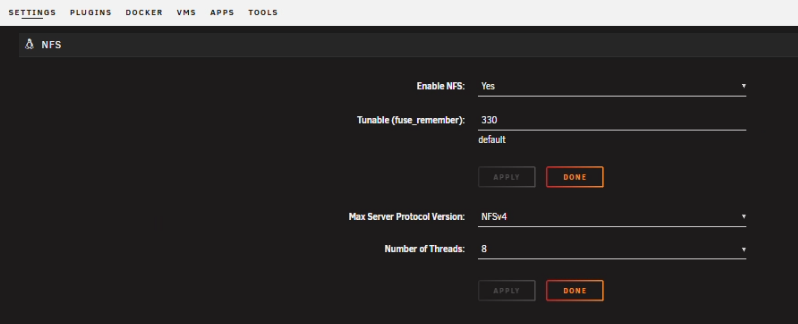

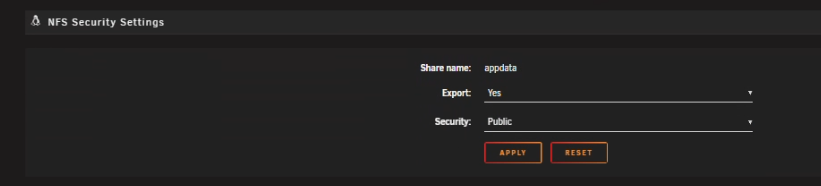

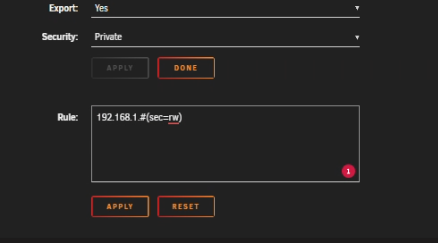

for linux to linux it better to use nfs... or sftp over ssh
Edited by bmartino1
I personaly prefer to use sftp...
filezila linux server docker and sftp docker in teh CA....
