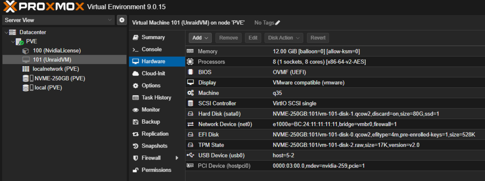

With Proxmox v9 and with the use of mdevctl lets pass a vgpu instance into unraid and take another look...

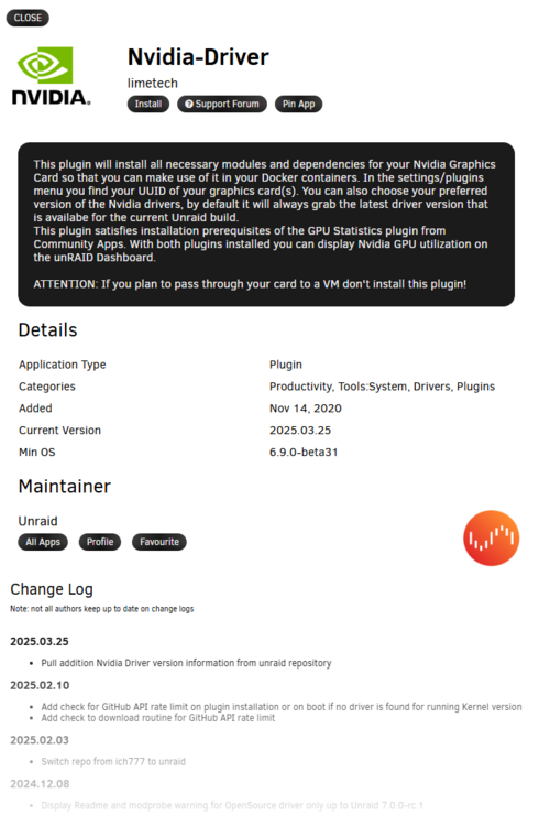

More with limetech taking over ich777 NVIDIA driver plugin and the introduction of the open source NVIDIA drive built in to the kernel.

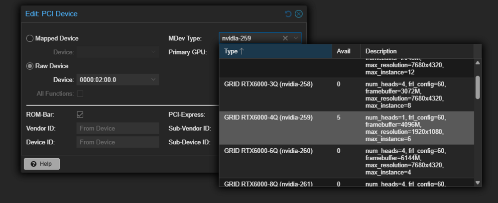

root@PVE:~# mdevctl types

root@PVE:~# uname-r
-bash: uname-r: command not found
root@PVE:~# uname -r
6.14.11-4-pve
root@PVE:~#
The Point Legaly this is Legal and Possible...
So I have Unraid Virtualized..
Note same guest driver and system works with vgpu in windows and ubunt / debian... so this is entriely a driver / unraid install issues!

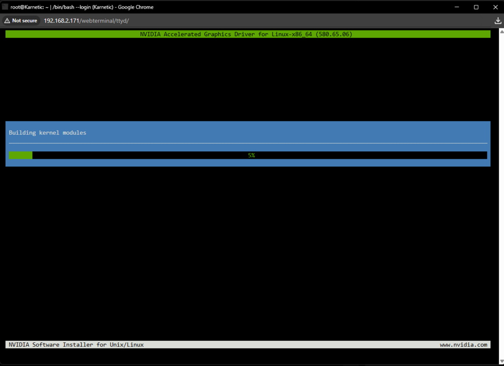

So some core dataL
Attached Diag before script run... more on thea t latter... esentail silmar to what teh uraid plugin do at boot to ghet drivers... as the consumer plauing will see it says the license request taits the kerneal and nvidia-smi breaks in unraid... (woudl be a bug report if the issues wasn't driver and hardware related due to VGPU... so Feature requst is what I landed on so the Devs can see this...)
since the plugin is a bust... let try to install teh nvidia drvier...
karnetic-diagnostics-20251119-1032.zip
Some quick notes that diag would share text is saved...

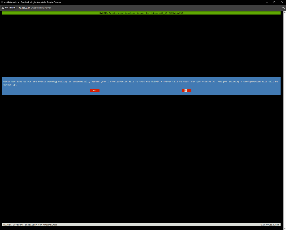

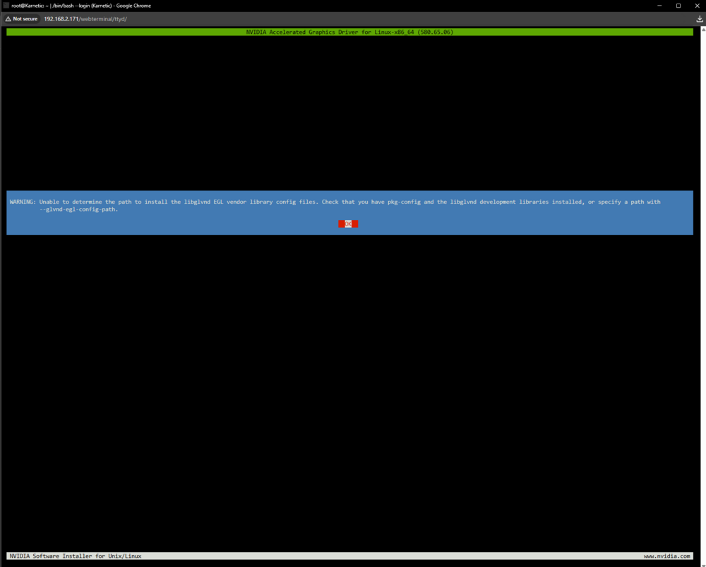

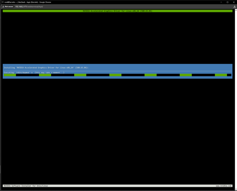

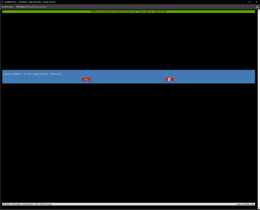

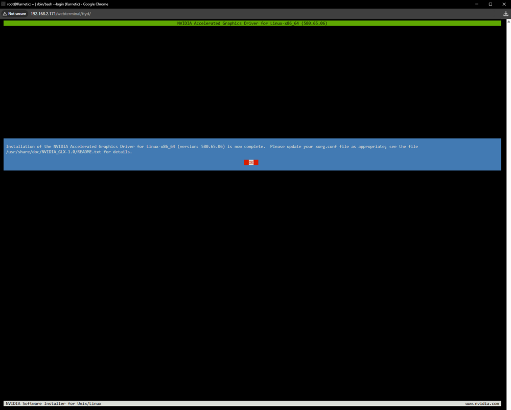

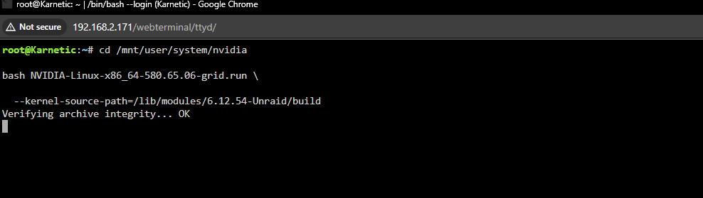

SO lets install the nvidia run... thanks to unraid and slackware living in ram we will need a stagin area.
I chose to use /mnt/user/system/nvidia
as this is a requiremnt latter to stage out of and is used in mutaged code for docker and other unraid stuff...
my files and what I have where
root@Karnetic:~# uname -r
6.12.54-Unraid
root@Karnetic:~# cd /mnt/user/system/
root@Karnetic:/mnt/user/system# ls

with this in place the run file will now work...
so now its time to rn the installer...
sript for me to install
cd /mnt/user/system/nvidia
bash NVIDIA-Linux-x86_64-580.65.06-grid.run \
--kernel-source-path=/lib/modules/6.12.54-Unraid/build
This is installign the Guest driver found in the guest folder. exampel here:
https://github.com/nvidiavgpuarchive/index/blob/main/details/857d43_Complete_vGPU_19.0_package_for_Linux_KVM_including_supported_guest_drivers.md
Guest_Drivers/NVIDIA-Linux-x86_64-580.65.06-grid.run
I chose no as my scirpt killed the 32 bit side for the compile onthe host.. the goal is to install the run file...
*32 bit faield due to me not having access to the necssary kerneal and file to build agaisnt and since i'm in my end enviroment i see no reason... too Deva may but would have access to this IF they add this to a suported featrue of there nvidia driver and bzroot...
we then build
I bootd non gui mode... so no
I get to sucess screen:
sucess outside every reboot i have to run teh installer... but this is where teh FEATURE REQUEST COMES IN!
the driver is installed and apears to be working I now have and ran run nvidia-smi...
termainl
root@Karnetic:~# cd /mnt/user/system/nvidia
Verifying archive integrity... OK
Uncompressing NVIDIA Accelerated Graphics Driver for Linux-x86_64 580.65.06........................................................................................................................................................................................................................................................................................................................................................................................................................................................................................................................................................................................................................................................................................................................................................................................................................................................................................................................................................................................................................................................................................................................................................................................................................................................................................
bash: --kernel-source-path=/lib/modules/6.12.54-Unraid/build: No such file or directory
root@Karnetic:/mnt/user/system/nvidia# nvidia-smi
No devices were found
so now to do this on the legal sytem not is a dev env that not going to last nor stay this way... Proff of concept that yes release host can use and run the nvidia guest driver...
(Nvidia drive is not corectly installed even in teh home lab byp[ass method... I probaly could if i get teh keneal the dev have acces to before it becoems the bzroot they compile.)
But proof of concept sucess I can run the run file to install the gpu driver... sort of...
