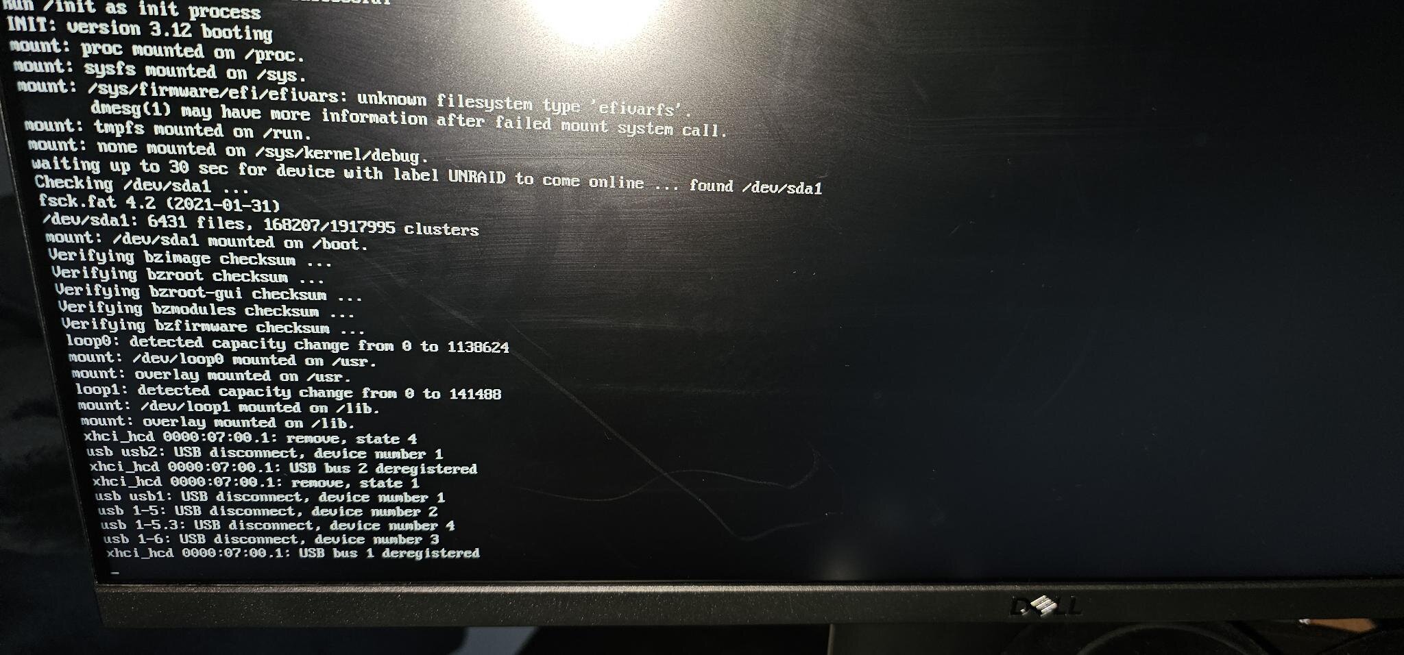

I need help — my Unraid machine crashes on startup after a reboot, see attached file.
I was running version 7.x.X, and I have an AMD Ryzen 7 5700X processor.
It does get an IP address, but the Unraid web interface doesn’t come up, and there’s no ping.
Here’s what I’ve done so far:
  • Changed the USB key to a different port
  • Backed up the USB key, then reformatted it
  • Created a new USB key
But the issue is still present.
Can you help m
Solved by gyto6
Did you create a vanilla USB Key without any data backed on it?
Did you boot on UEFI or Legacy?
Edited by gyto6
I recreated a USB key with my data.
I use UEFI.
Recreate without any data, boot, and check.
ok it's work without data,
Can you restore my data now ?
Try to import each plugins folder one by one with a reboot. to notice wich plugin makes you not bootable.
Okay, thanks, I’ll try and I’ll let you know
