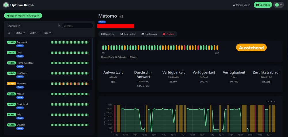

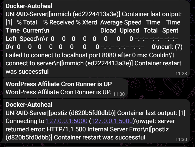

Hey there, some hours after Unraid 7.2.1 came out, I already updated. That's probably where the problems started. First, I thought it was about Traefik, but then I realised I get tons of problems that even healthchecks are failing sometimes, and a Docker container cannot reach the localhost. I guess it would be an option to completely remove the Docker folder and let everything reinstall, but it takes a lot of time to select all the apps again... is there a faster way?

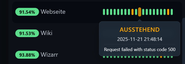

There are many networking problems. I run a WordPress instance, and I have many 500 errors. First, it said there is no contact to the DB, then to Redis. But it is not all the time. Sometimes it loads, and sometimes it does not. I had to disable Redis in WordPress because it could never connect, but the container runs and none of the configuration changed. The same Redis container works for other containers that need Redis.
You can see these random errors and restarts here. Out of nowhere, there is no connection, and it is in the container also some n8n flows failed or had a timeout. There is a general issue in my system that has nothing to do with exposed services. So it cannot be Traefik or Cloudflare.

I cannot believe this. It started again yesterday. Now it's only one container behaving like this. It started like this when I had this issue as well. After rebooting Unraid, it seems to work flawlessly for at least an hour, but in general, something is wrong because I can see that calls to the service need between 2000 and 30000ms, and sometimes even timeout.
