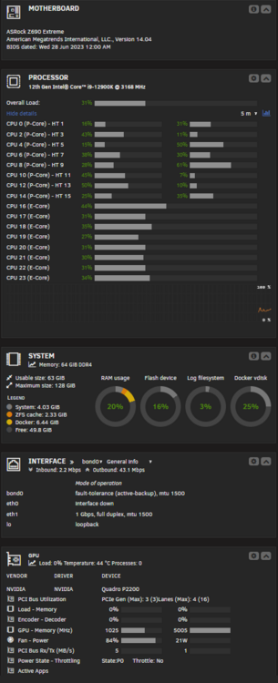

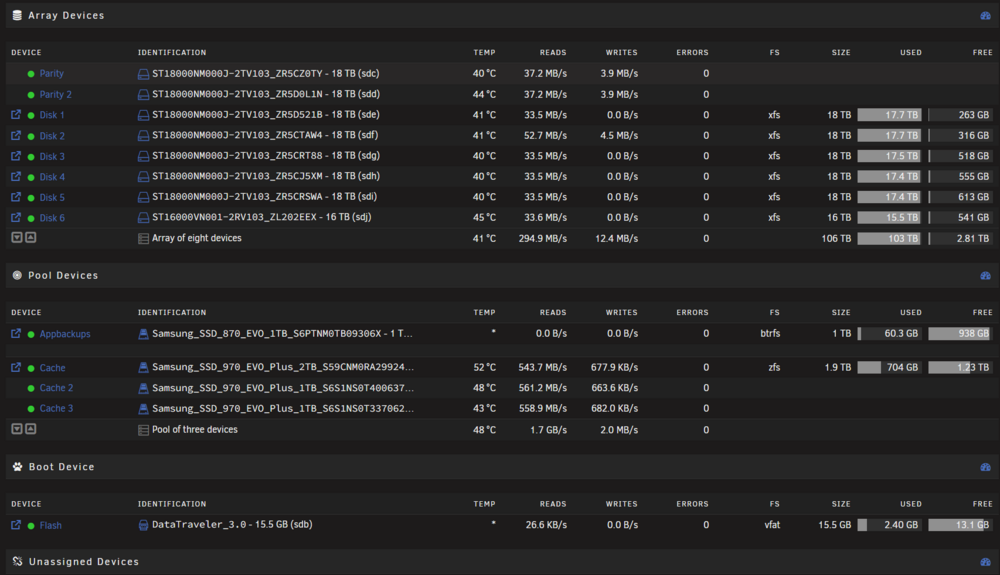

I have had a few issues in the last few weeks and they are as follows.
  • Dockers go missing from the system, requiring them to be added back using the template previously
  • Sometimes, during a re-add I get an error about the name already existing and the command failing
  • updates that never seem to go away or take approx 15-30 minutes to run, then failing with the above error about name existing .
  • dockers acting as if they are frozen and not responding for several minutes.
I have ran Live Memory Tester and not come back with any errors, and attempted to get into the bios of the motherboard but can not get anything to display ( although I might just be an idiot and not able to get it to pass through my GPU)
I have attached my system specs and am running 7.2.0.

Please post the diagnostics, mostly to see the hardware.
Nothing jumps out ot me, because Memtest is only definitive if it finds errors, since you have multiple RAM sticks, try using the server with just one pair, if the same try with the other one, that will basically rule out bad RAM.
Will do if i see any more issues, I did find that when I ran a parity check I had 1,000+ errors to be corrected and I also reran the appdata and docker permissions tool a 2nd time. At least for now that fixed the update problem I had.
Thanks!
