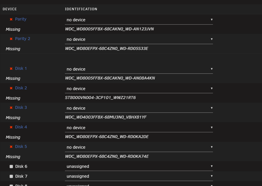

Array will not start, drives missing after 7.2 update
All drives connected to the RAID card are missing after updating Unraid to 7.2.
No hardware changes were made.
If I roll back to Unraid 6.12 everything is back to normal.
What is going on?
Supermicro X9DRi-LN4+/X9DR3-LN4+

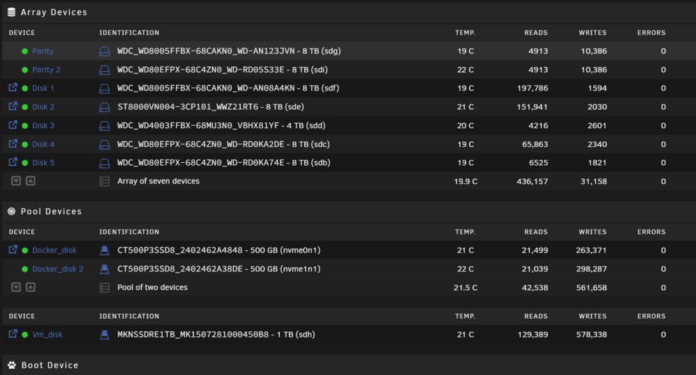

Here are the logs after I rolled it back to Unraid 6.12.
All drives are working.
