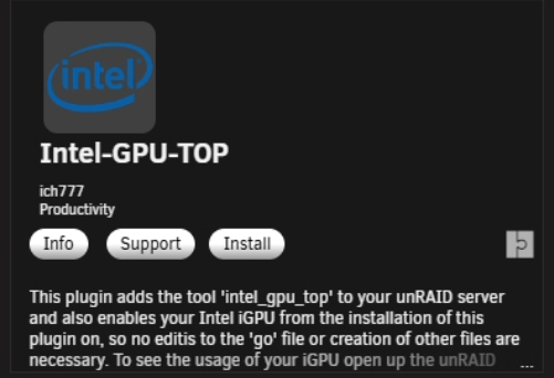

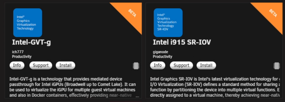

Please install the intell i915 driver. The intel gpu top plugin...
And if needed (depending on the board the beta driver...)

Thank you very much. Intel-GPU-Top was installed before. The i915 driver package was missing.
Playback seems to run fine now.

I also activated SR-IOV support in the BIOS. No change...
