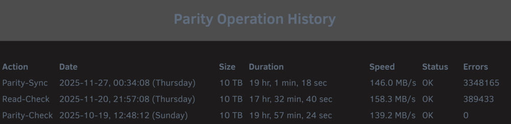

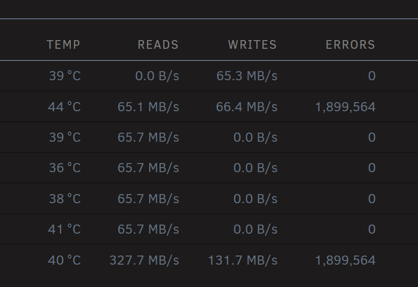

I have Parity and 5 disks, and then I think it died a parity sync but the parity device got disabled so I could only do read check but that succeeded. So I tried to add back the parity by turning off the array and then removing my parity, starting in maintenance and then adding back but now it looks like this. I believe it may be a cabling issue that I touched the cables before as UDMA and reallocated count went up, but at the same time does the read errors mean it failed to read my data drive for the parity?
As I killed the parity drive by reassigning it and I no longer have dual parity I am not sure what I can do now to check further the issue. Right now it is currently still rebuilding.
This is the drive 1 with read errors

The initial issue as I understand was that the parity drive became disabled, and then I noticed there was read errors, but I did a read sync after parity and same errors.
The parity is now done but there was read errors, so can I consider this parity okay? Or is there still a possibility that the issue corrupted the other drives?
Parity was disabled though I am not sure if read errors from disk 1 caused it to be disabled, so I unassigned it, started array maintenance and stopped array and added it and parity rebuild, and now it is done. And we have read errors on drive 1 currently.
Nope.
Did you replace its cables and try again? If yes, post new diags after the new errors.

I restarted and reseated all cables, and I notice now that disk 1 is disabled and content is emulated, but we know disk 1 had read errors, so should I now recreate the array and recreate parity or what should next step be?
If parity was rebuilt with errors on disk1, it won't be valid. Recommend replacing the cables, then doing a new config to re-enable disk1 and try building parity again.
