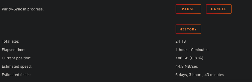

Parity sync seems to be runnning incredibly slow (<50mb/s). Please help
I have 8 discs running in an array with one parity of 24tb. The other 7 discs are of size 14tb x 2, 12tb x 2, 4tb x 2, and 3tb. this is in a qnap tld800c enclosure, using beelink with 128gb cache running unraid. why would my parity sync be running at only <50mb/s? i do not have any docker containers running.

You are using USB, that is not recommended for various reasons, including performance.
I’m not sure I understand what you mean. Are you referring to the boot device?
edit: do you mean i should not be using the tld800c? if so, would you mind making some recommendations?
edit 2: i'm seeing that qnap makes a PCIe to SAS interface card. Is that what you're recommending to do? Trying to see if that's most cost effective way to proceed...
Edited by oniisan
I mean that all the array disks are connected via USB. For best performance and reliability, we recommend SATA or SAS.
