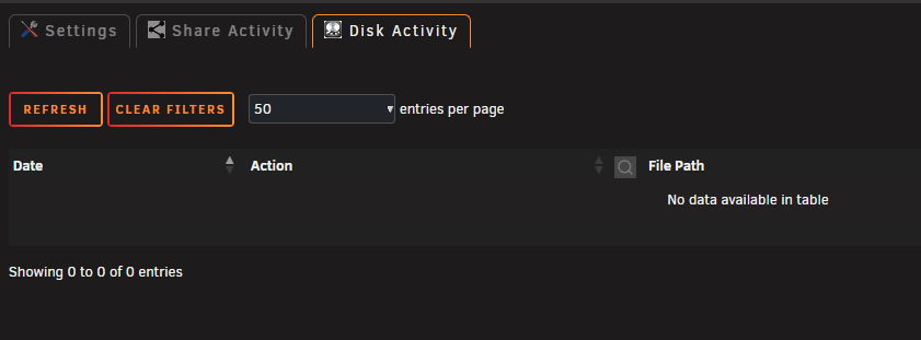

i have File Activity but it is empty, i have disabled all the docker that have access on media on those disk, but they will keep randomly spins.

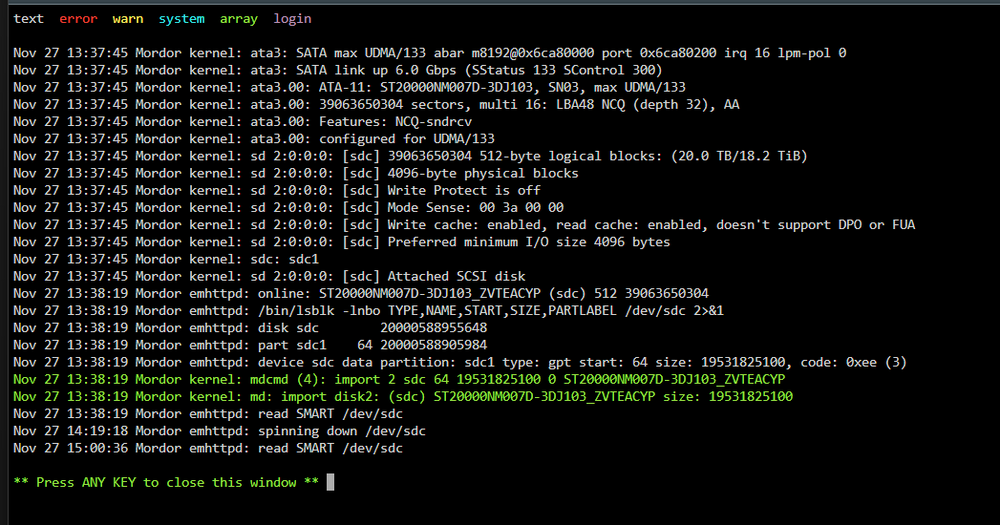

In the disk log i have read SMART but, as i understand, the SMART is triggered because someone spin up the disk and it is not the cause

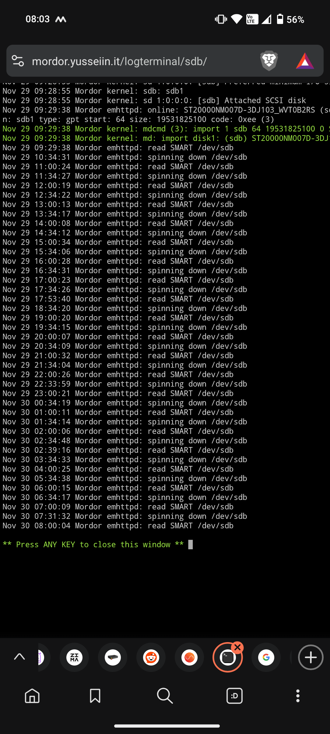

This is getting really annoying disk 1/2 will spin up/down every 30 minutes without no one using it...
These seems happening after updating to 7.2.2 and having Unraid Connect Plugin working
The disk spins up almost exactly at the top of each hour, e.g.
29 Nov 10:00:24
29 Nov 11:00:24
29 Nov 12:00:24
29 Nov 13:00:24
29 Nov 14:00:24
To me this suggests there's a script, plugin or something else running hourly causing the spin-up for that disk

Seems something related to the CA Mover, it makes the disk spin even if it wont move any file. For now i have disabled the scheduler, as soon i have some more time i will try to see the log and check why.
