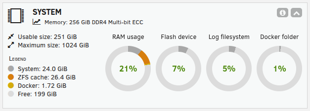

The SYSTEM memory taken up by the rogue NFSD process is still taken up; it got up to 24G of RAM and my machine's still showing a "SYSTEM" memory load of 24G while under normal operations it usually sits around 6-8GB of SYSTEM memory.

I may reboot this system today to try to free that memory up unless you have any specific commands you'd like me to run to gather data. I have attached an updated diagnostic dump since I did not reboot the server, just restarted the array. The problem is not occurring right now since I restarted the array except for the "lost" memory. If it starts again I can try to run the strace again but I just tried strace again on an existing NFSD process but it doesn't appear I can attach to any of them. strace against another process running on the system (Pi-Hole) returns data as expected. NFSD processes all return "Operation not permitted"
