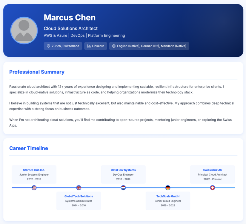

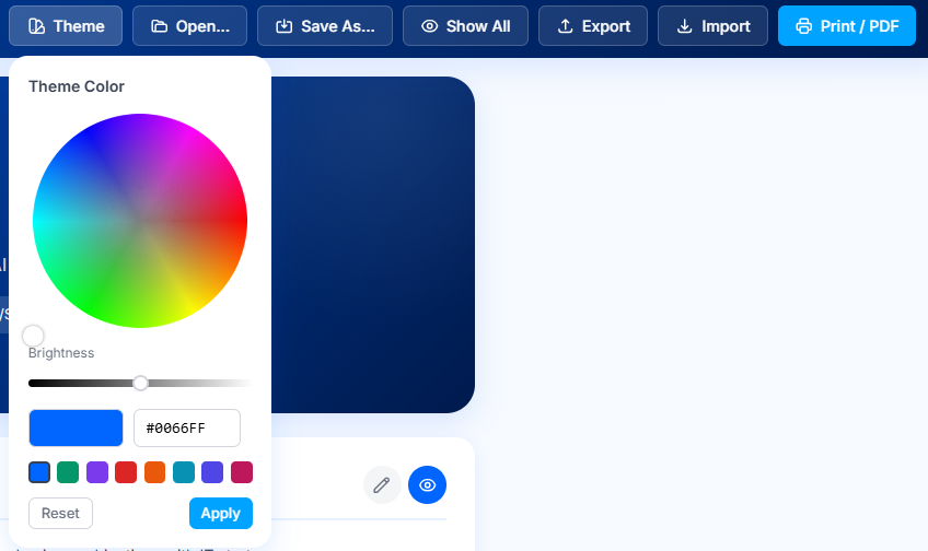

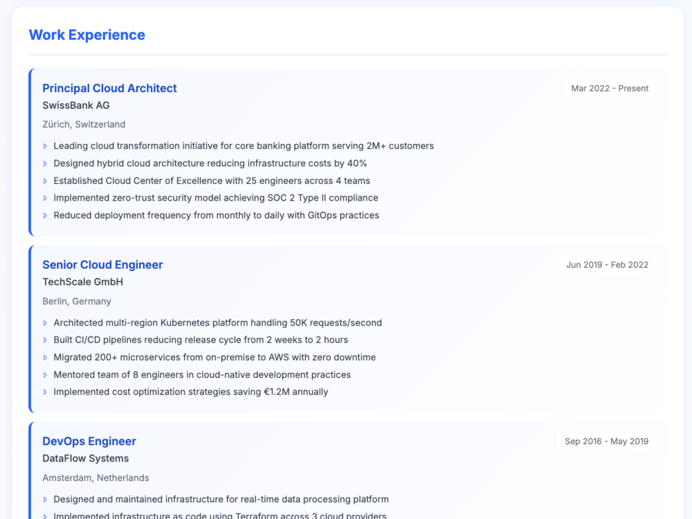

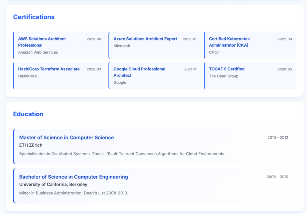

New support topic for the CV Manager / Resume Builder app: an application to manage your self hosted CV with editable theme, slick template, export/import feature and ATS friendly PDF printout.
Base features
Example
Repo: https://github.com/vincentmakes/cv-manager
User Guide: https://github.com/vincentmakes/cv-manager/blob/main/USER_GUIDE.md
