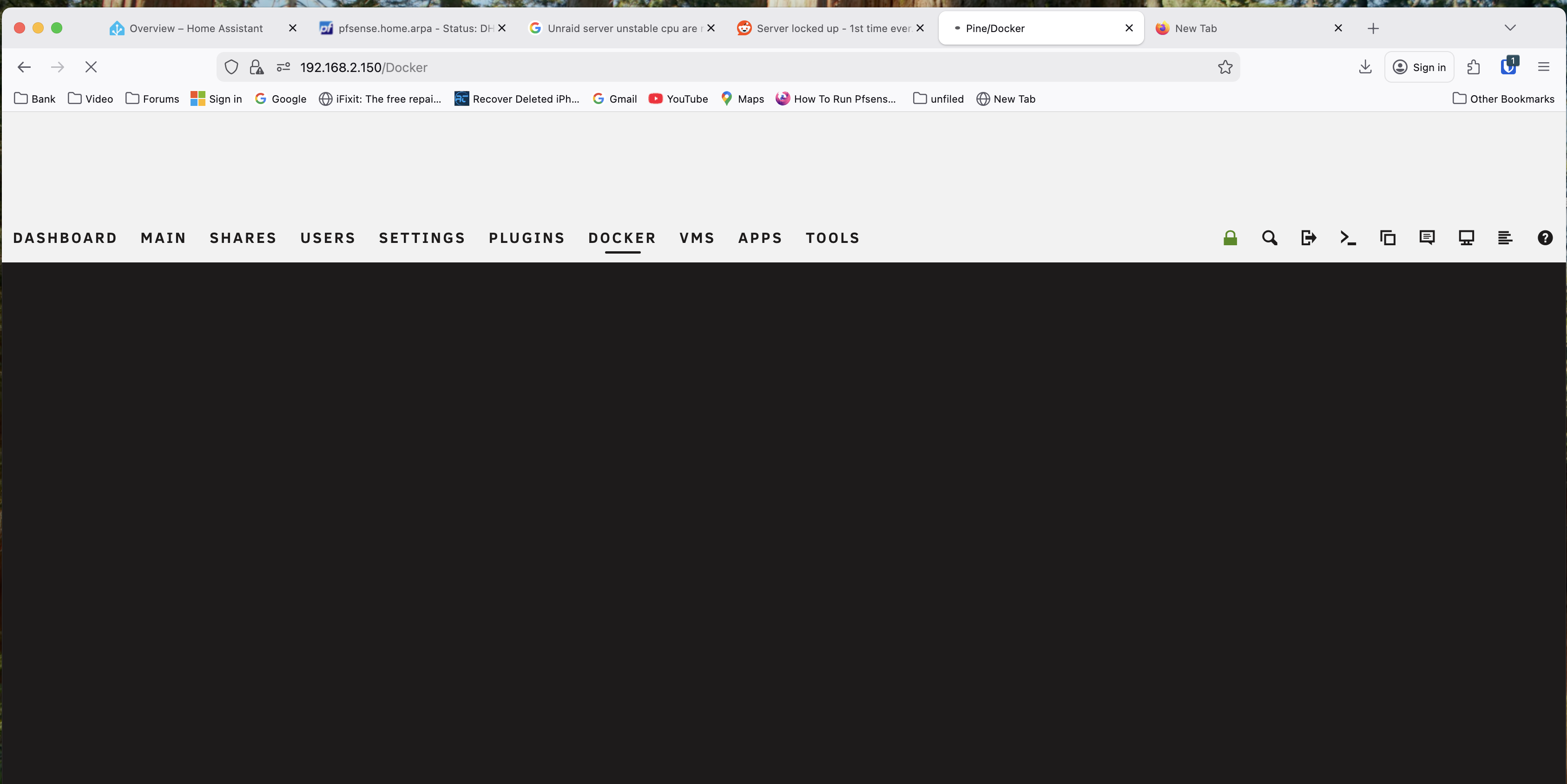

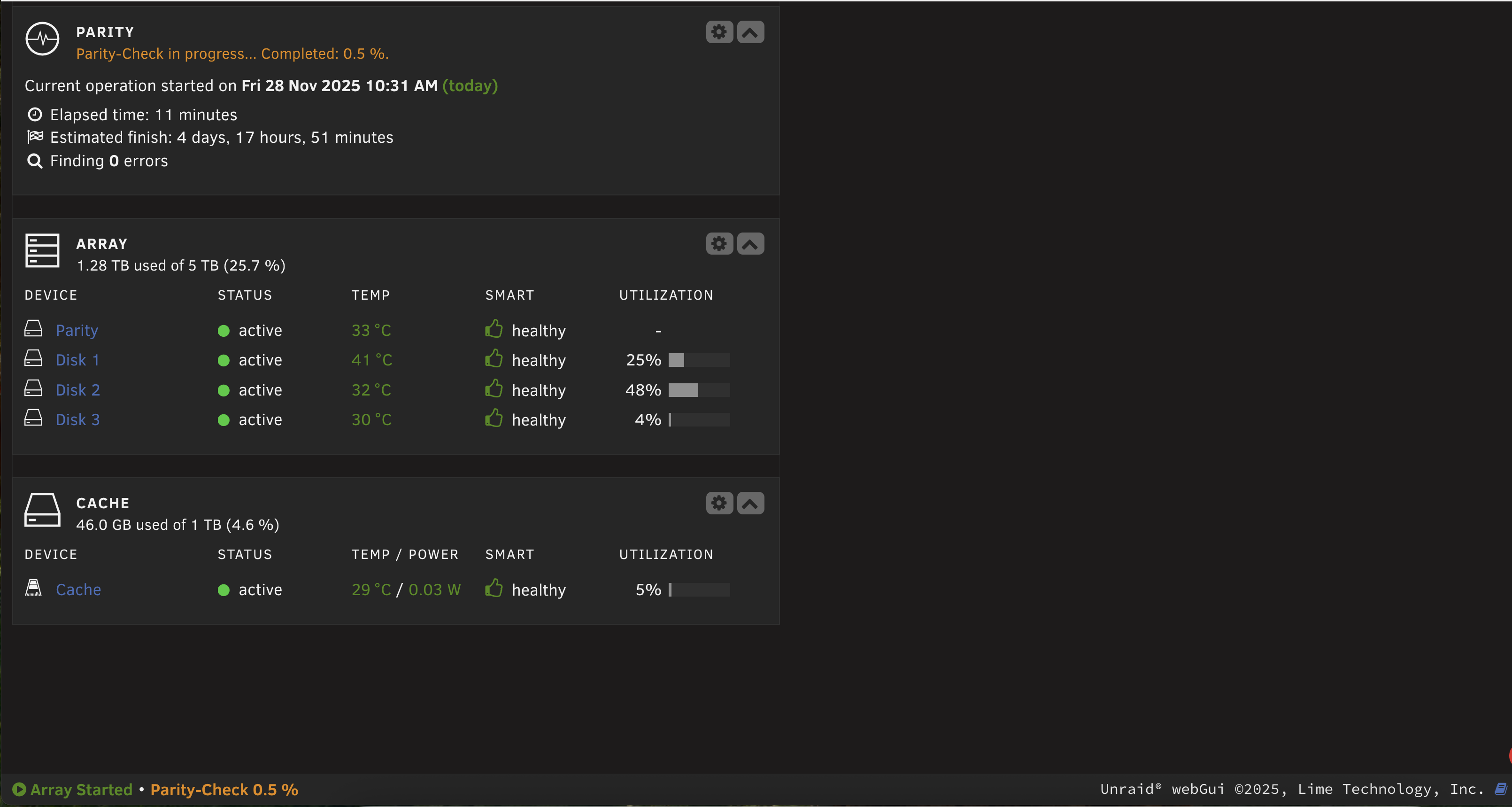

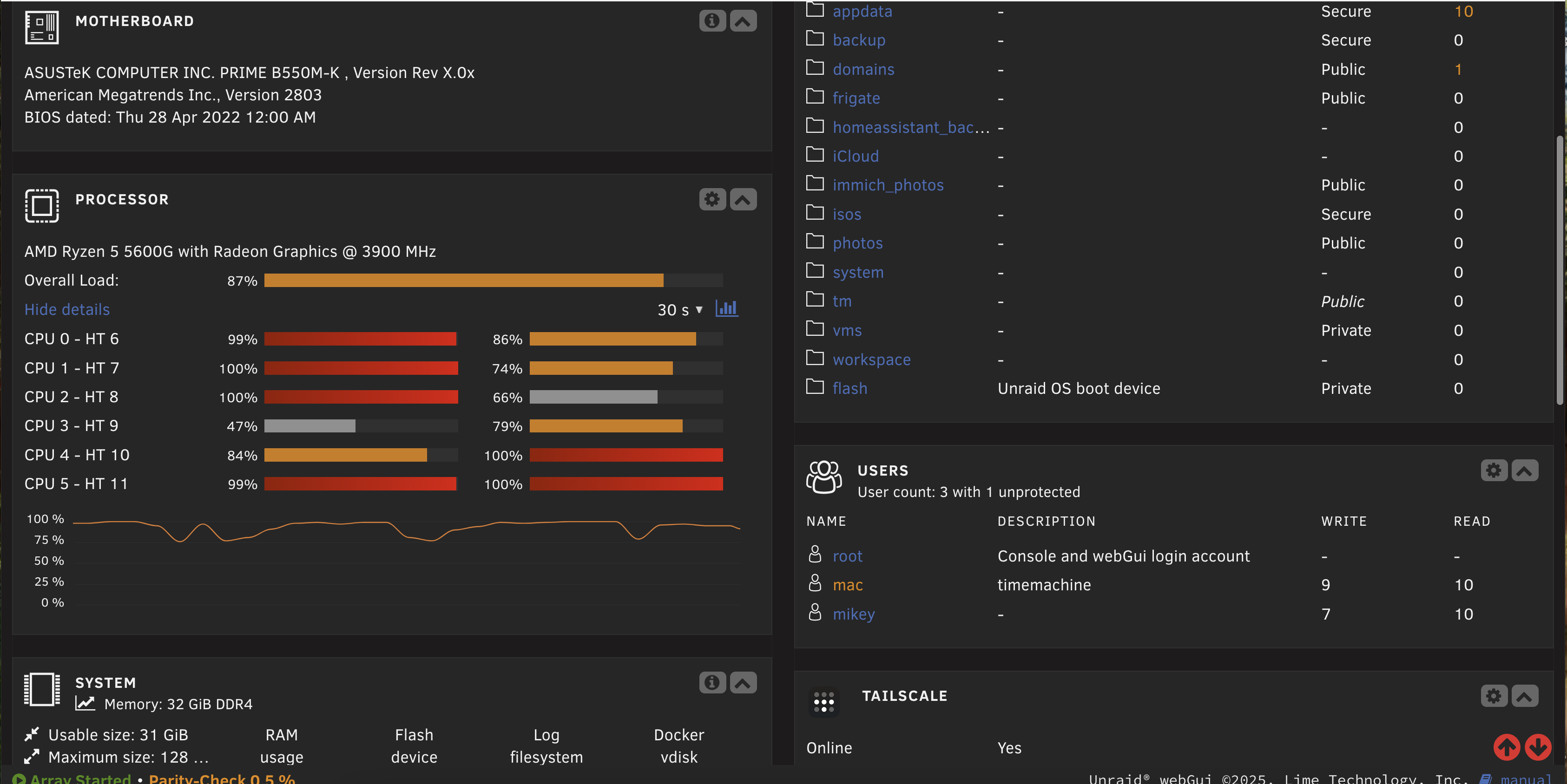

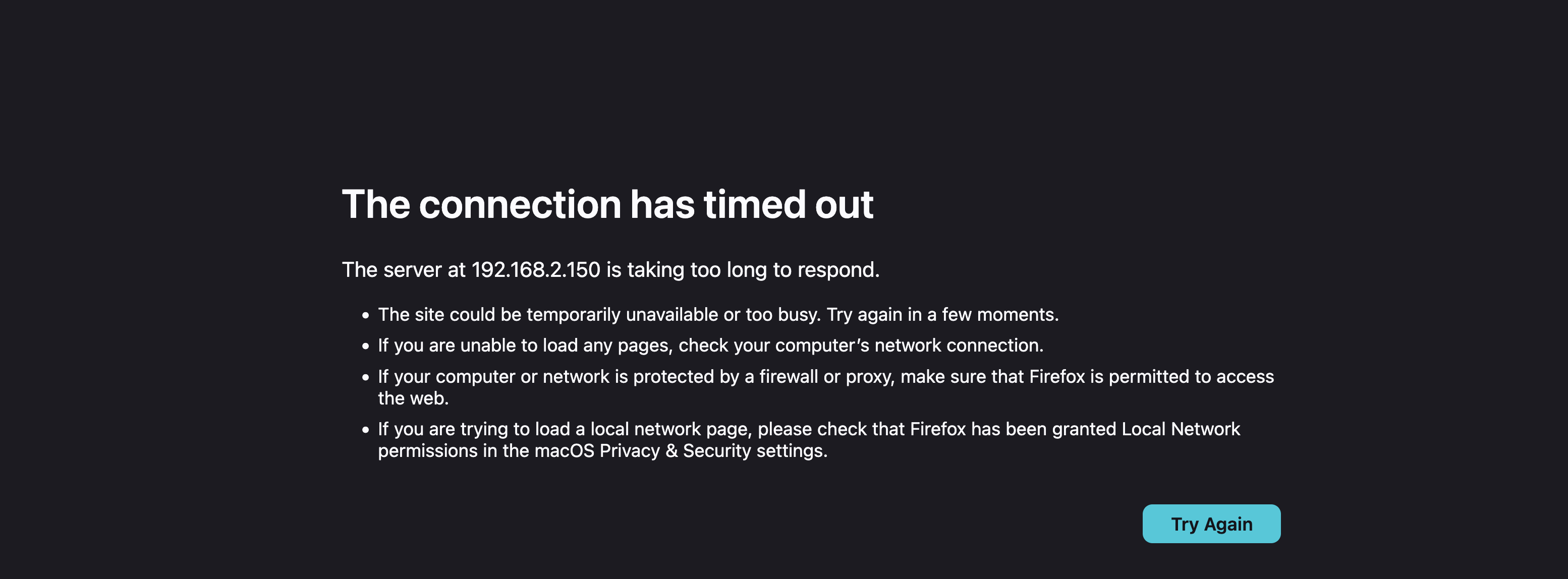

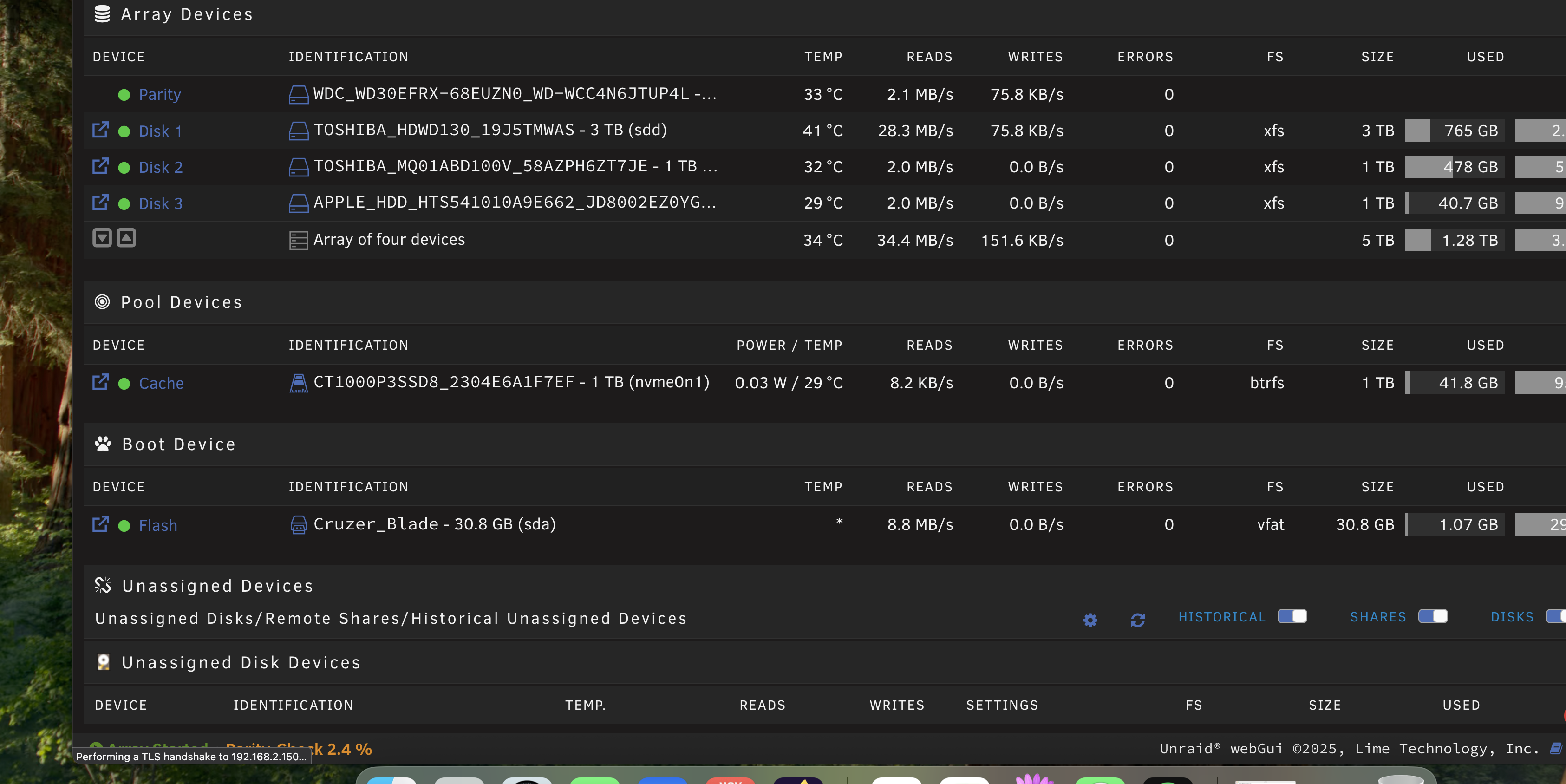

Hi I have been have issues where unraid using 100% cpu, last days i was unable to load up on the local Ip so i used a back and changed the IP. It loaded but took an age to load and all cpu were maxed out. I was unable to move arround the from main to dashboard or any other. I was finally able to get the diagnosic and download the file. Also some screenshots before failed.
I trust that someone could find the time to look a the diagnostic file and and give some help as it is fine when its working this i cannot find a solution. It is currently doing a Parity -Check .

In my experience, these errors can be the result of the server being close to exhausting the memory, GUI can become extremely slow, like 1 minute to open the dashboard, try limiting the memory for VMs/docker services, or adding a little more RAM.
It could also be one or more containers hogging the CPU, try pinning only some cores to them, and leave cores 0/1 available for Unraid.
Also, recommend trying a couple of other things, go to Settings - Global share settings and set the Number of fuse File Descriptors to the max, and enable this:
https://docs.unraid.net/unraid-os/release-notes/7.0.0/#excessive-flash-drive-activity-slows-the-system-down
