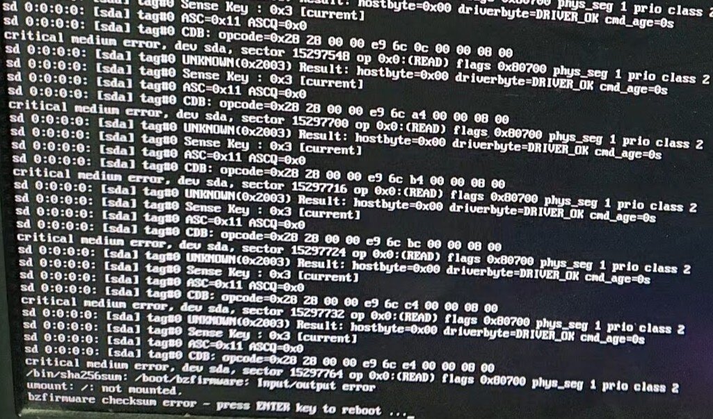

Unraid wont boot, bzfirmware checksum error

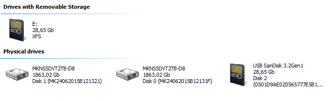

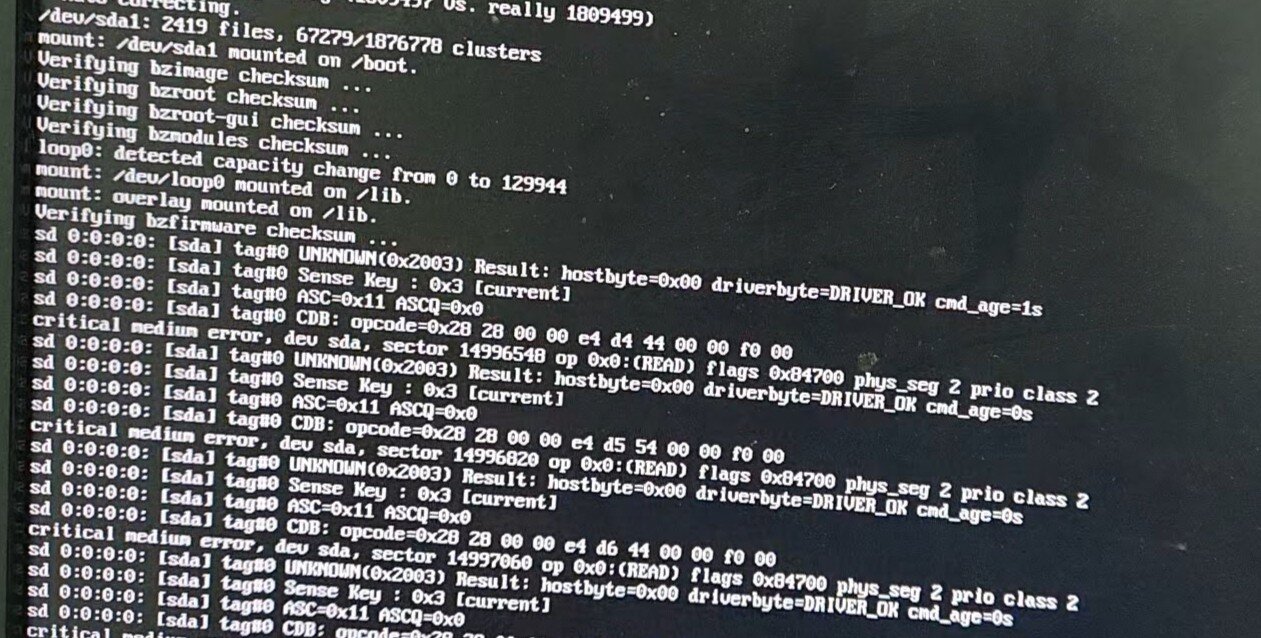

I tried to check for logs on the my boot flash drive, for some reason it is in XFS format so i had to use a program called Linux Reader. I didn't see a config folder or a log folder only an app data folder. So i had to take photos of the logs as it booted.
Why do you think it is in XFS format?
Boot flash must be FAT. You will have to prepare it properly before it will boot.
Because with the program DiskInternals Linux Reader says so.
Id like to clarify that this has been my boot unraid drive since i built my server is 2022 so its been running for 3 years.
What i would like is some clarity is this a flash drive issue or is one of my hard-drives failing, it seems the issue is with "dev sda"?
Do i need a brand new boot drive? or does it just need to be reformatted?
Do you have a current flash backup?
I do not, I checked to see if there was a backup on unraid connect but there was a problem where i didnt have any keys on my account and now i dont see the backup i made last year.
OK so it is the USB that's the problem and its time to get a fresh drive with a fresh install. Thanks
