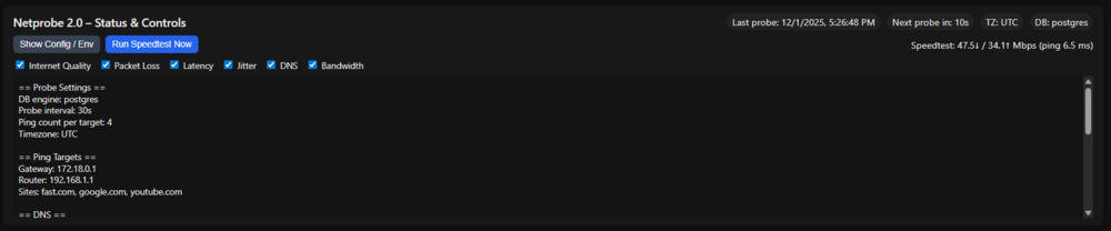

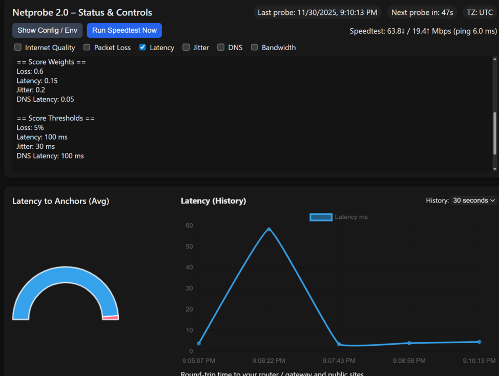

Netprobe 2.0 – Internet Quality Dashboard
Netprobe 2.0 is a lightweight, container-friendly network probe and web UI for home / lab internet monitoring.
It periodically:
  • Pings your gateway, router and a list of “anchor” sites.
  • Measures packet loss, latency and jitter.
  • Measures DNS lookup latency per DNS server.
  • Runs scheduled and manual Speedtest.net tests.
  • Stores everything in SQLite and renders a dark-mode dashboard with Chart.js.

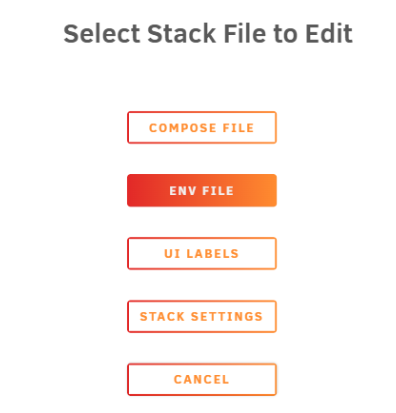

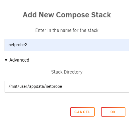

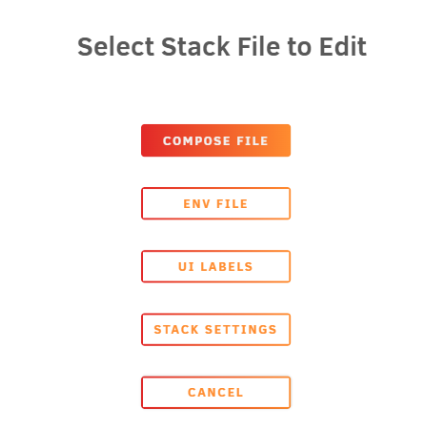

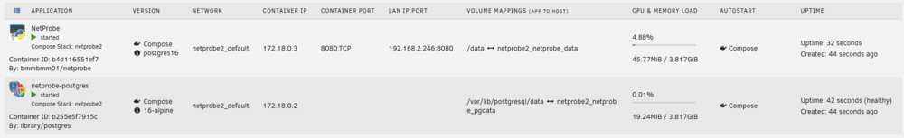

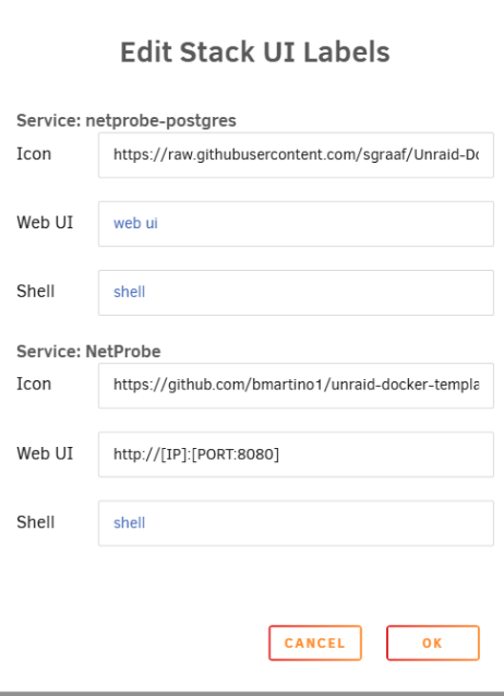

Now onto Unraid Setup:
Then with the docker compose plugin installed, we link the folder /mnt/user/appdata/netprobe
Then edit the stack. It should autoload the github version... this version will build the docker for you to run so if you want to make html js or even python changes to the probe.. Be my guest...
Here is a compose file for Postgres all in one:

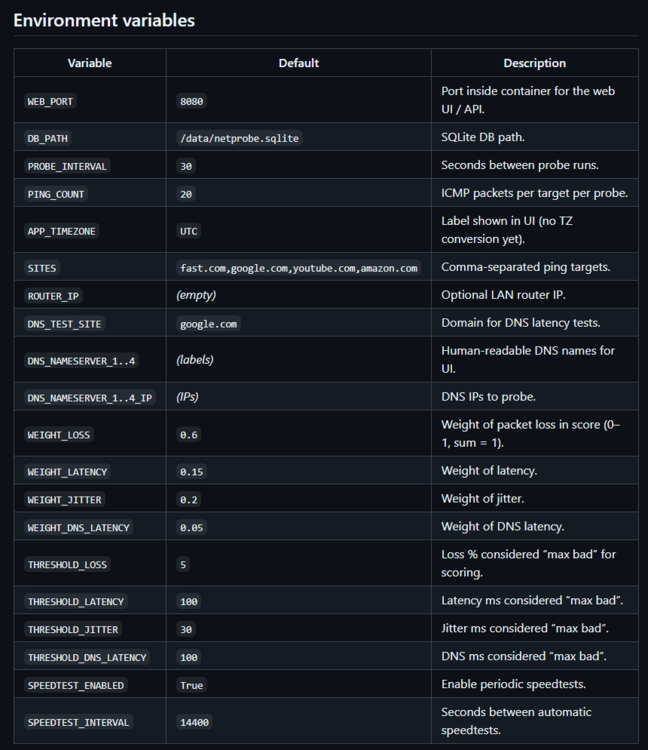

and a example env file:
# NetProbe + Postgres (.env for Unraid)
# This file is read automatically by the
# Docker Compose (compose.manager) plugin
# Core Netprobe settings
WEB_PORT=8080
APP_TIMEZONE=UTC
# Probe timing (you can leave defaults if you want)
PROBE_INTERVAL=30
PING_COUNT=4
# Database backend (Postgres)
# Use Postgres docker variables...
USE_POSTGRES=true
DB_ENGINE=postgres
# Postgres connection details (must match postgres service)
POSTGRES_HOST=postgres
POSTGRES_PORT=5432
POSTGRES_DB=netprobe
POSTGRES_USER=netprobe
POSTGRES_PASSWORD=netprobe
# Ping targets
# Comma-separated list of external sites to ping
SITES=fast.com,google.com,youtube.com
# Router IP on your LAN
ROUTER_IP=192.168.1.1
# DNS config
DNS_TEST_SITE=google.com
# Only overriding DNS #4 to be your LAN DNS;
# DNS 1–3 will fall back to built-in defaults.
DNS_NAMESERVER_4=My_DNS_Server
DNS_NAMESERVER_4_IP=192.168.1.1
# Speedtest configuration
SPEEDTEST_ENABLED=True
# 4 hours in seconds
SPEEDTEST_INTERVAL=14400

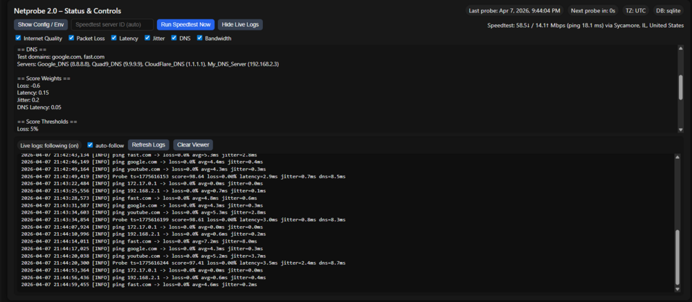

Hi. Trying this out and I added a bunch of sites to ping.
Should I be able to see the ping latency, jitter, and packet loss to the individual targets in the web gui? I see that the feature is available for the DNS servers.
When I look at the log files, I can see that each of the sites is being pinged.
I wanted to ask since I couldn't find any obvious setting and before I started poking around in the code.
I know it seems like a lot of sites, but I just like to know if there are any problems hitting sites anywhere around the world...
Thanks for any suggestions and all the programming! Seems like a nifty app!

2026-02-04 14:04:38,456 [INFO] ping us-sea-as55002.anchors.atlas.ripe.net -> loss=0.0% avg=244.8ms jitter=0.6ms
2026-02-04 14:04:41,505 [INFO] ping us-dca-as11039.anchors.atlas.ripe.net -> loss=0.0% avg=37.9ms jitter=1.0ms
2026-02-04 14:04:44,624 [INFO] ping uk-lon-as12008.anchors.atlas.ripe.net -> loss=0.0% avg=110.3ms jitter=0.5ms
2026-02-04 14:04:47,743 [INFO] ping de-fra-as14061.anchors.atlas.ripe.net -> loss=0.0% avg=111.2ms jitter=0.4ms
2026-02-04 14:04:50,873 [INFO] ping ch-zrh-as62371.anchors.atlas.ripe.net -> loss=0.0% avg=124.5ms jitter=7.6ms
2026-02-04 14:04:54,008 [INFO] ping se-sto-as12008.anchors.atlas.ripe.net -> loss=0.0% avg=126.8ms jitter=0.6ms
2026-02-04 14:04:57,230 [INFO] ping au-syd-as12008.anchors.atlas.ripe.net -> loss=0.0% avg=215.2ms jitter=1.6ms
2026-02-04 14:05:00,405 [INFO] ping jp-tyo-as12008.anchors.atlas.ripe.net -> loss=0.0% avg=167.2ms jitter=0.4ms
2026-02-04 14:05:03,656 [INFO] ping sg-sin-as63949-client.anchors.atlas.ripe.net -> loss=0.0% avg=243.3ms jitter=0.5ms
2026-02-04 14:05:13,480 [INFO] Probe ts=1770231826 score=90.58 loss=0.00% latency=75.8ms jitter=0.9ms dns=817.9ms
Q/A
  1. Should I be able to see the ping latency, jitter, and packet loss to the individual targets in the web gui? I see that the feature is available for the DNS servers.
    *Only in the log the script run a formula to calculate it and adds to the chart web page and SQLite/Postgres engine database, then display it on the container website/chart.
    Example:
  2. When I look at the log files, I can see that each of the sites is being pinged.
*This is by design to help with what's happening script-wise and what is running to generate the data...
  1. I wanted to ask since I couldn't find any obvious setting and before I started poking around in the code.
    ?ask what exactly I'm not getting a clear question here. Where to add the extra dns names?
    see docker env:
    https://github.com/bmartino1/NetProbe_Python?tab=readme-ov-file#environment-variables
    by default I only have 1 dns name for it
In theory, you could change and/or add more, but atm I think its set to uses only one DNS location, as one was enough to grab the data required...
https://github.com/bmartino1/NetProbe_Python/blob/main/probe/app.py
I would have to edit some Python variables to open it up for ?csv style dns names? simalr to sites...
like google.com,fast.com,etc...

what I'm doing to get the data: line 638
# ---------- DNS probes ----------
dns_times = []
dns_per_server = {}
for server_ip in DNS_SERVERS:
t = measure_dns_latency(DNS_TEST_SITE, server_ip, count=3)
if t is not None:
dns_times.append(t)
dns_per_server[server_ip] = t
avg_dns = statistics.mean(dns_times) if dns_times else 0.0
Currently I'm using sites only for ping to grab that data... not dns. as ping is what would give me the latency / jitter....
I will look into editing and adding more than one dns for probing. There is quite a bit that would need to be updated, including database integration and website display for more than 1 target...
(Currently I don't have plans to edit / update.)

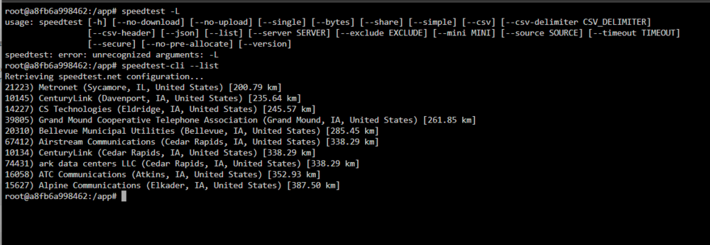

Is there anyway you can add the ability to pick a speed test server?
Kind of I'm using the default speedtest binary / python. the CLI technically, there is a way with the CLI to specify the speed test server you're testing from.
speedtest-cli: How to Specify a Server - Hivelocity Hosting
Speedtest CLI: Internet speed test for the command line
The speedtest command in the docekr should use speedtest.net and auto pick the closet / best test server automatically...
I will look into it when I have free time and add that as a potential docker environment and feature request.
Asnard above. I have slept since then and we'll need to reread the code to re-add or change features, but that should be a fairly simple change or add-on as I have to change the speed test command and add an ENV to set a site, assuming that the speed test CLI accepts custom inputs for that option.
Edited by bmartino1
data - typo
Feature request updates and changes in coming..
speedtest-cli --list
you will still need to run this line in the Docker to see availbe speedtest id to set it manually...
Options preferred set at docker env level
# Optional: force speedtest to use a specific server ID.
# Leave blank to use automatic best server selection.
# The web UI can override this value for a one-off manual run.
SPEEDTEST_SERVER=
you can add the Docker env and number to set the server at the Docker template or manually run them in the index page via the id number...
-Knowledge is needed beforehand thus the env will not be in the template... by default design it will still be set to auto...
There is a Docker tag update change happening soon as I bring this Docker stack back to lattest a templte update will be implemented shortly.
See release notes for updates:
