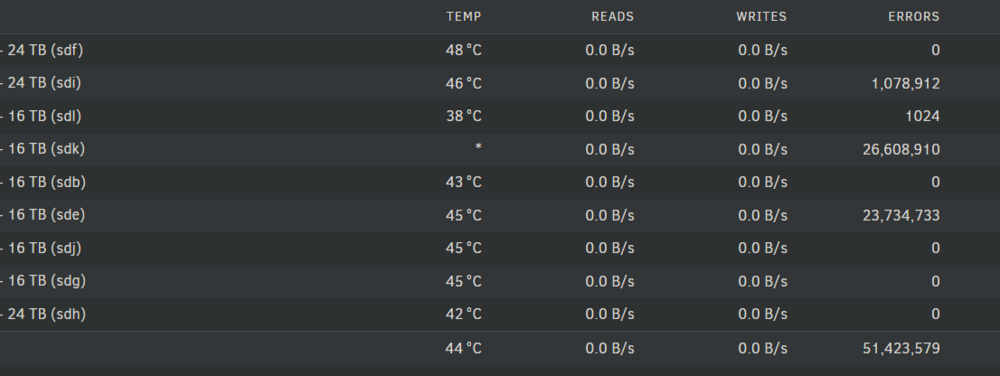

-After that it's been nothing but problems, it started saying that one drive is unusable.
-I tried removing it from the array re-assign it and rebuild but after wards other read errors started popping for other drives so I decided to cancel the rebuild for now.
-I also tried moving most of the drives from the motherboard SATA ports to the LSI card thinking there might be some issue with the motherboard, a little better but I still get errors during a rebuild or read check.
-I also tried changing a few SATA cables to no avail.
-Since so many different drives are throwing errors, I decided to pause the current rebuild attempt I was doing since the same drive becomes unusable during the rebuild.
I am not sure that buying a new drive will solve this issue, if I had to take a guess I would say it is motherboard related?? I do not have access to another mobo for testing.

I decided to order a new motherboard, new sata cables, new sata power cables, new psu and 2 spare drives and try to pin point the issue by checking the drives 1 by 1, I know you can't really speak without any form of logs but I do have a syslog and I also would like to know what would be the best approach to take when I get the new hardware, should I attempt another rebuild with a new drive (even if some others gave errors without failing), or should I attempt to slowly transfer everything to the brand new drives and then move the data drive by drive to just restart an array as if I was a new user with an unprotected array of xfs drives trying to build parity?
Until the re-build attempt, Unraid was able to emulate the array, so I took advantage of that to catalog all my media but after the failed rebuild attempt I stopped because of too many read errors, I am missing some files which are probably from the failed disk, I'm not asking for a super specific answer but if you had to take some shots in the dark, how would you go about it?
Obviously I won't have any diagnostics to post until I get the new hardware and I really hope I won't have to post new ones because I really don't want this to happen again 😅
Part of me really want to point a failing motherboard connection or PSU because even the ssds on my cache pool by the end started throwing read-errors, no way an NVME, 3 enterprise drives and 1 ssd would show all the same errors at the same time being from totally different times of purchase and batches in my humble opinion.
