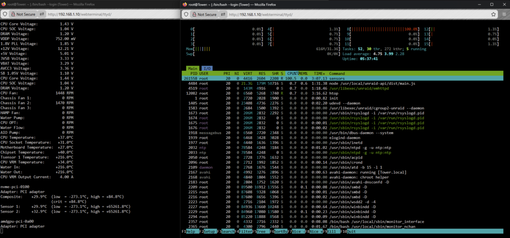

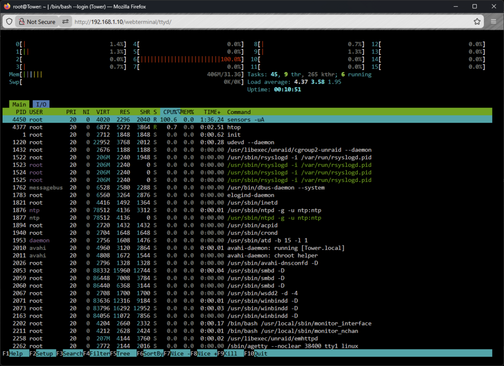

After logging in the fans started spinning up again and the UI became unresponsive. Long story short, I found out that there is a process called sensors that runs with the syntax -uA that is eating up 100% CPU time on a single core. The single core the process utilizes changes every few seconds.
I believe this is the cause of my web UI locking up and my fans running at full tilt. I've also found that this process starts to use 100% CPU (1T) whenever I go to the Dashboard from the web UI. I found this out by using the terminal and htop command. Here is a screenshot of it going. As you can see in this instance it has been running at 100% CPU utilization for over 3 minutes. I've had it take 15 minutes+ before.

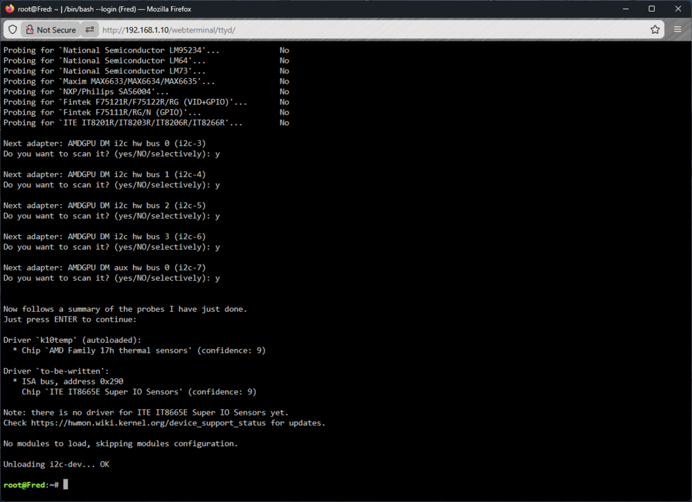

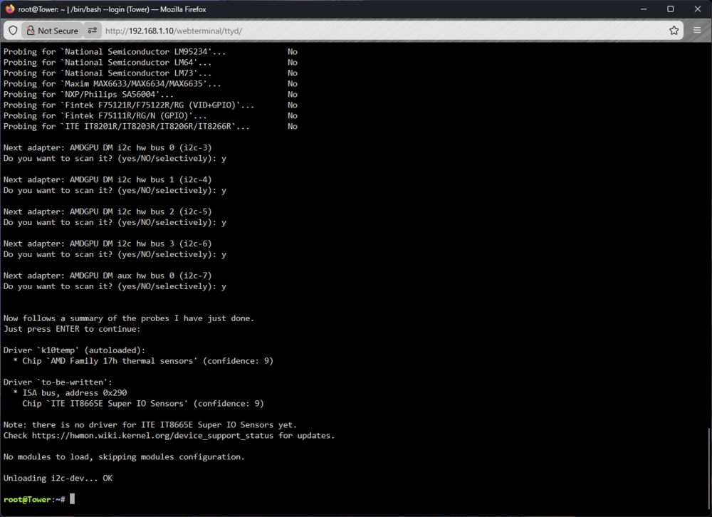

I did some brief googling and the AI overlords said to try running sensors-detect command. This led me through some prompts to scan for various sensors. I said Yes to all checks to detect all sensors. It then gave me a summary of what it did but I am not sure how to interpret the output. I am not super experienced in linux environments. Here is the end output.

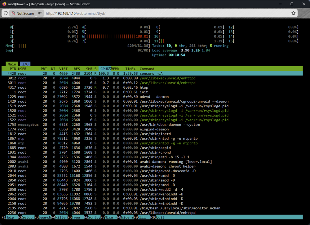

I believe 7.1.2 and 7.1.3 were the Unraid versions I tried previously and had thought they failed. I now believe they were probably just stuck waiting for this sensors process to stop using 100% of my CPU. But I still wanted to get proof of that so first I started with 7.1.4 as you suggested. This is a fresh install on a different USB drive so there is no config setup here. I am seeing the same issue on 7.1.4 as I do on 7.2.2. CPU time is up to 4 minutes+ and the Dashboard hasn't loaded.
7.1.4

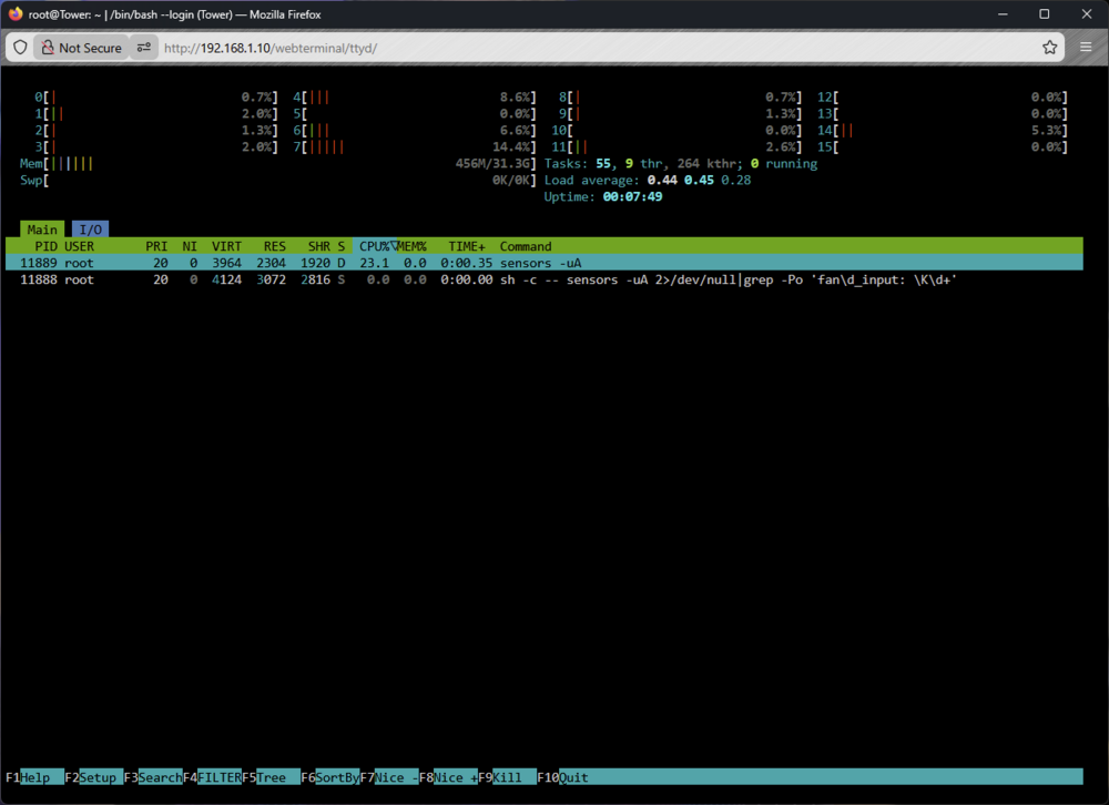

Again, I've downgraded my 7.2.2 production install down to 7.0.2 and the issue does not present itself. However, to be thorough I installed a fresh copy of 7.0.1 (I saw no option to download 7.0.2 from the Unraid USB Creator tool) to test it as well. The dashboard takes maybe half a second but loads right up. When I monitor htop and click the dashboard tab on the web GUI I do see the sensors -uA process use CPU time for a split second but it's so fast I can't track it. Using F4 to filter only for "sensors" I do see it sporadically show up, but it does whatever it needs to do and stops running. Here is a screenshot I grabbed of it appearing for a brief moment.
7.0.1:
As the issue isn't happening on 7.0.1 ran through the sensors-detect prompts again. It looks identical to the output from 7.2.2 (screenshot on original post) but here is the output at the end in case it helps.

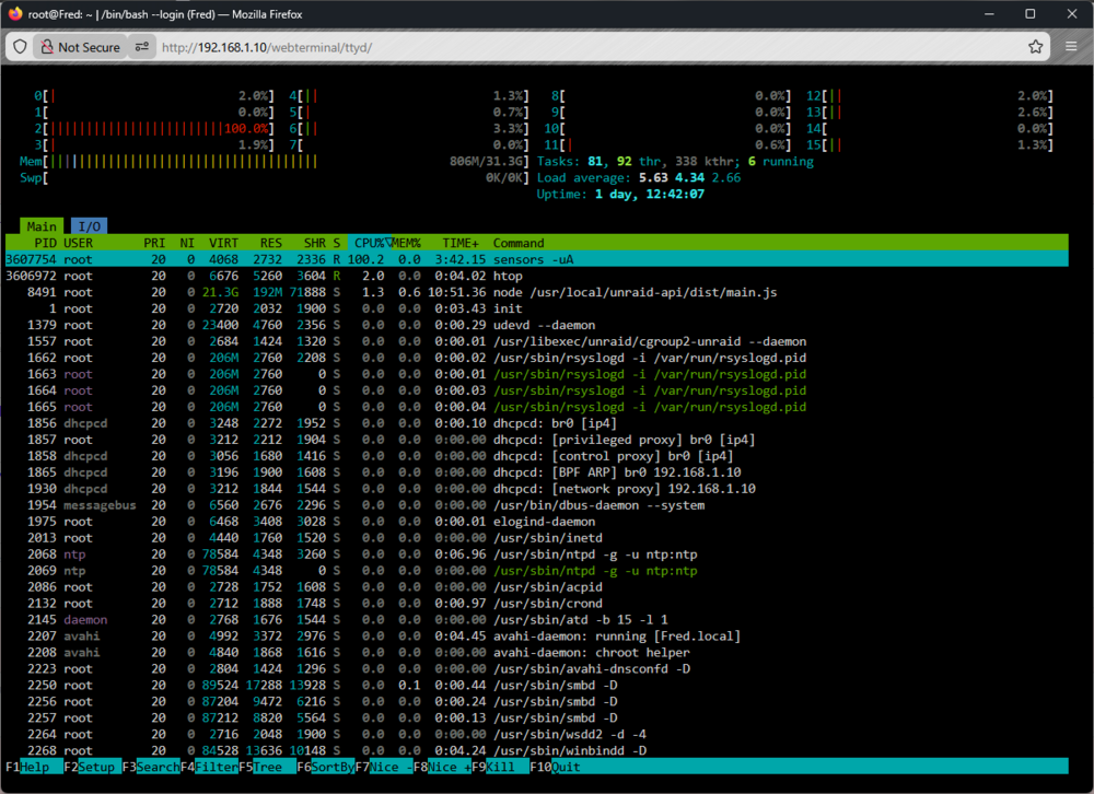

I wanted to do more testing so I installed a fresh copy of 7.2.2 and booted up. I opened up two terminal windows and ran the sensors command. It runs fine until it gets to this part:
amdgpu-pci-0a00
Adapter: PCI adapter
Once it gets there it hangs there for minutes. Using the other terminal window I am monitoring htop. When the process hangs the CPU will spike to 100% and boucne around various cores. This is the exact same behavior as when I click on the Dashboard tab. It looks like the Dashboard is calling sensors to poll their data.
The same happens when I run the sensors command with the -A or -uA syntax. Those syntax's just display more information. It always gets hung on detecing
The current GPU is an AMD R9 380. I'll try uninstalling the GPU to see if it behaves the same way. I also have an old Nvidia GPU I can try putting in for more testing.
