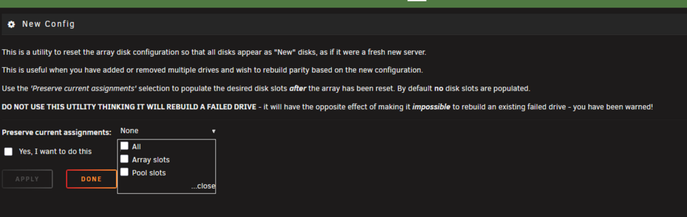

1 hour ago, lovingHDTV said:
Do I have to remove the drive from the array completely, rebuild, then add the new drive?
You can use Tools-->New Config and keep all slots as is with current disks and adding the new XFS v5 disk in place of the old drive. This process will let you rebuild parity based on the new disk. You want this so parity knows about the new disk and file system. It will not rebuild the new disk from the old one and you do not want this.
