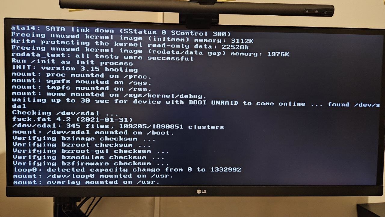

Hello everyone,
I'm setting up a gaming VM on my Unraid server and facing a boot issue after installing a new GPU.
Hardware Configuration:
  • Motherboard: Gigabyte H410M H V3
  • CPU: Intel Core i5-10400
  • RAM: 32GB
  • New GPU (for VM Passthrough): AMD Radeon RX 6600 (ASRock Challenger D)
  • PSU: Corsair CV550
The Problem:
  1. VT-d Disabled: If I leave Intel VT-d (IOMMU) disabled in the BIOS, Unraid boots perfectly fine to the Web GUI.
  2. VT-d Enabled: If I enable Intel VT-d (IOMMU) in the BIOS (required for proper Passthrough), the Unraid boot sequence stops and freezes at the following message:Exiting up to 30 sec for device with BOOT UNRAID to come online (you can check more details on the attatched image)
Question:
How to solve this? I never did a GPU Passthrough before so I might be missing something.
Thank you very much!
Test with a new flash drive using a tock install; no key is needed, if it still happens, it suggests a hardware compatibility issue with the kernel; look for a BIOS update.
