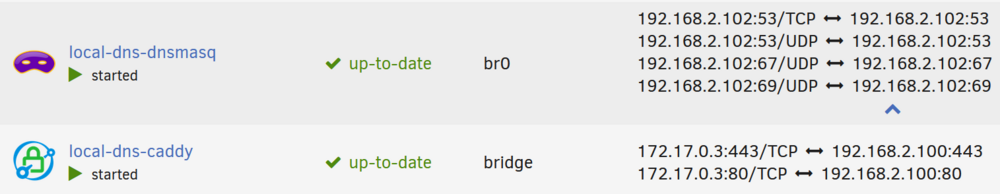

  • DNS: 192.168.2.102 - Dnsmasq, br0 docker network; listening on port 53 and points to 192.168.100 (reverse proxy)
  • R-Proxy: 192.168.100 - Caddy, bridge docker network; listening on port 80 and 443 (I moved the default unraid GUI ports)

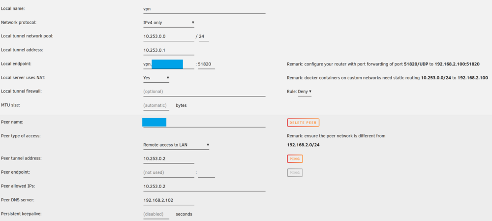

  • Unraid built-in wireguard enabled. Forwarding in router for udp 51820 enabled

Wireguard config
Docker container
This works well when I'm directly connected. If I set my dns server on windows to 192.168.2.102 (dnsmasq container) I get forwarded from app1.example.com to 192.168.2.100:8085

Now when connected to my home network through wireguard it does not work anymore. My guess is that the traffic does not find its way back to me.
I'm not sure if this is a problem with me using bridge + br0 docker network, if it's the NAT setting in wireguard or anything else.
When dnsmasq is configured as dns while I'm connected I can no longer reach any website and I get no response from app1.example.com I can only reach my internal containers by using IP + Port (f.e. 192.168.2.100:8085)
