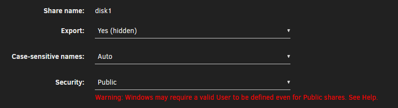

Shares (user or disk) are visible to WIndows if they are set to be exported. Since Windows can see /mnt/disk3/Photos you have disk shares set to be exported. I have five disks in my array and here are the setting for disk1 as an example:
Export Yes (hidden) means that the shares are potentially visible in Windows, but, they don't show by default, you have to know and type in the network path in the Windows Explorer. In the case of the disk share above, as you know, I enter /mnt/disk1/ to see folders and files on that disk.
