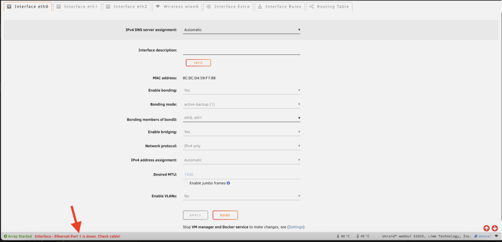

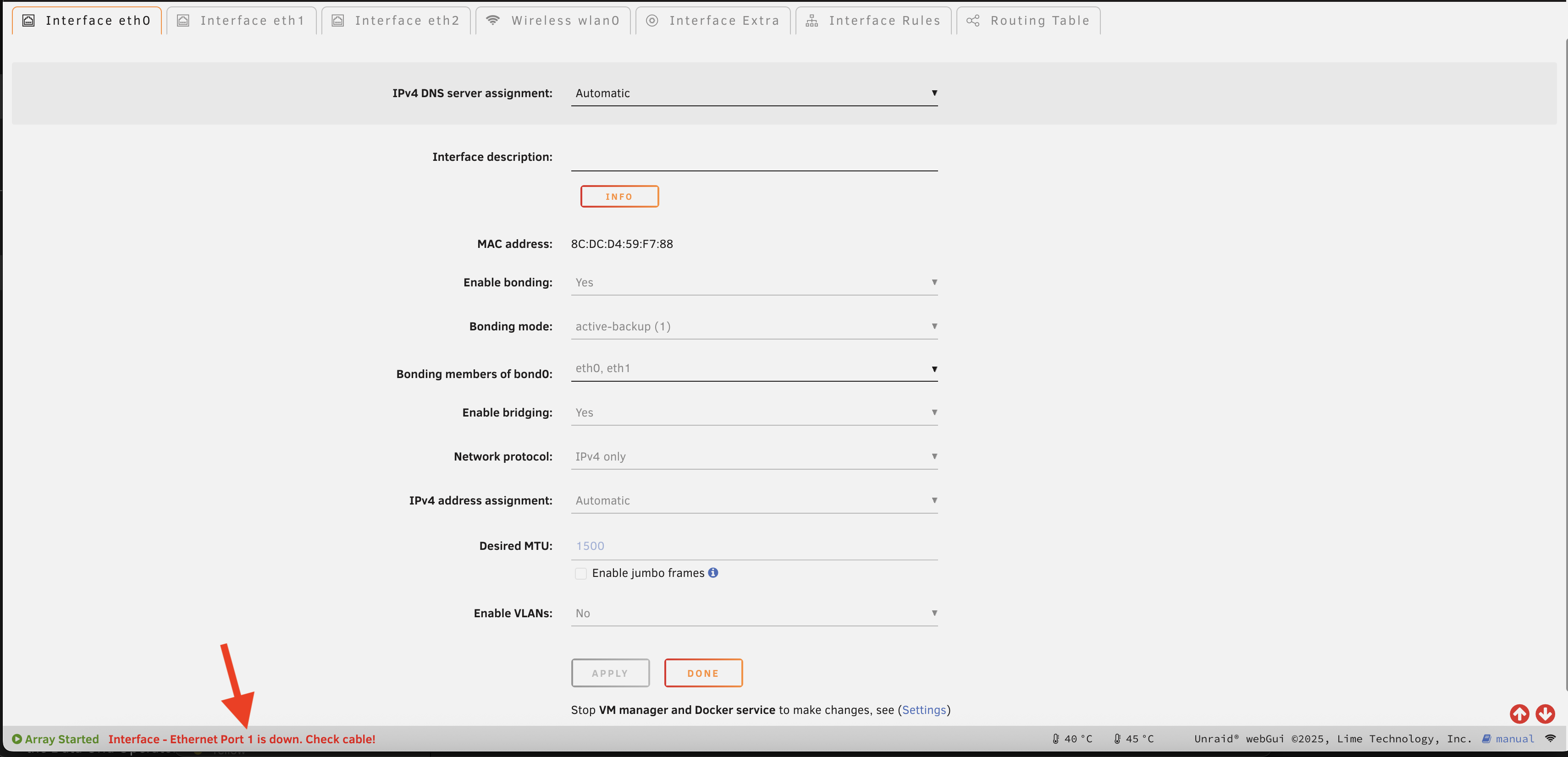

I checked the network setting on dataserver2(screenshot attached):
  • it's the same as its been for the last few years
  • I have a PCIE 10Gbps dual port SFP LAN card
  • I am using only one of the 2 ports, there is no cable in the second port
  • I have IPv4 DNS server assignment set to Automatic as I use the mac address on my router to set my static IPs.
  • however, I noticed the red message at the bottom of the screenshot attached. I do not remember unraid displaying an error for having a unplugged port in a active-backup bond mode. Could that be the reason for the issue on this server. Meaning ports in the bond must be connected?

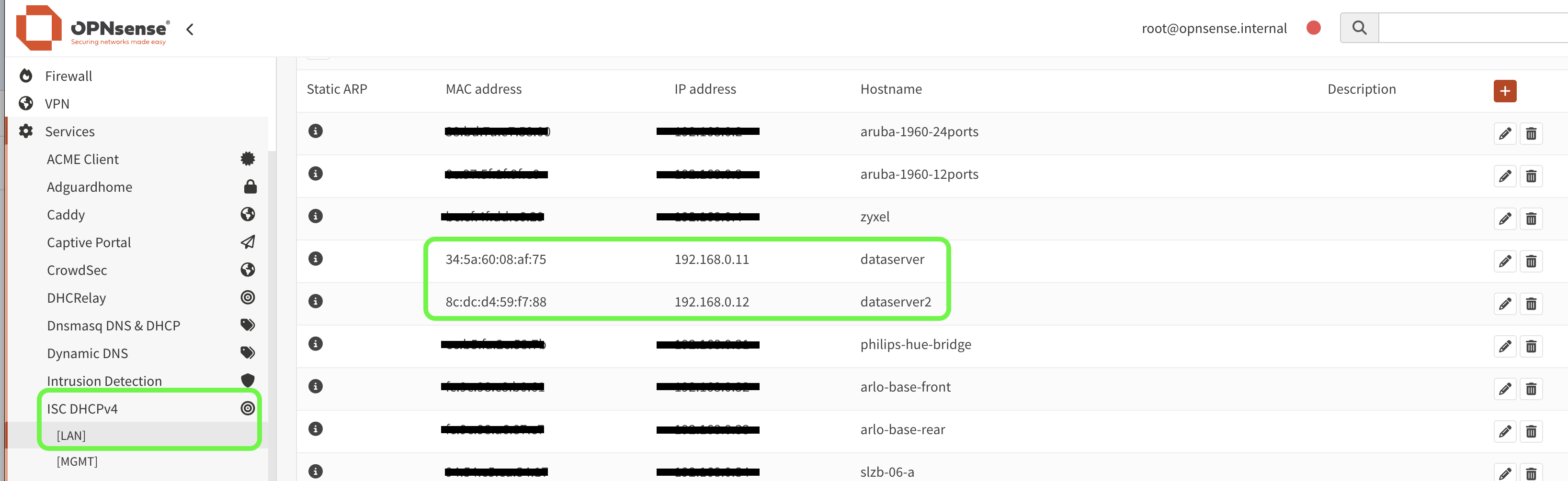

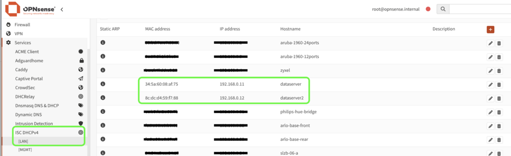

Thanks @JorgeB .
I will try the below seperately and see if the problem occurs after each change:
  1. disable bonding on dataserver2 and dataserver
  2. remove static DHCP ARP MAC Address IP mapping for dataserver2 and dataserver (see attached) and set static IP in unraid directly. I use opnsense as my firewall and router.
I will aim to upload diagnostic after running the change #1 above for a day and you can see. if the bond0 issue goes away as well as the DHCP issue.

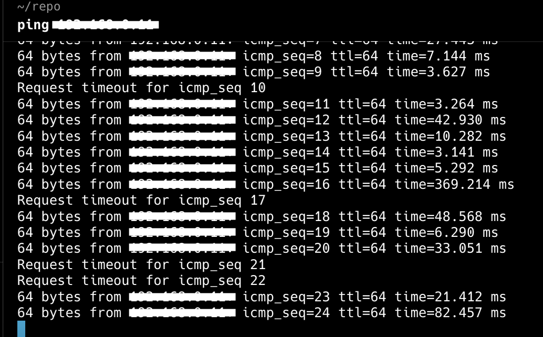

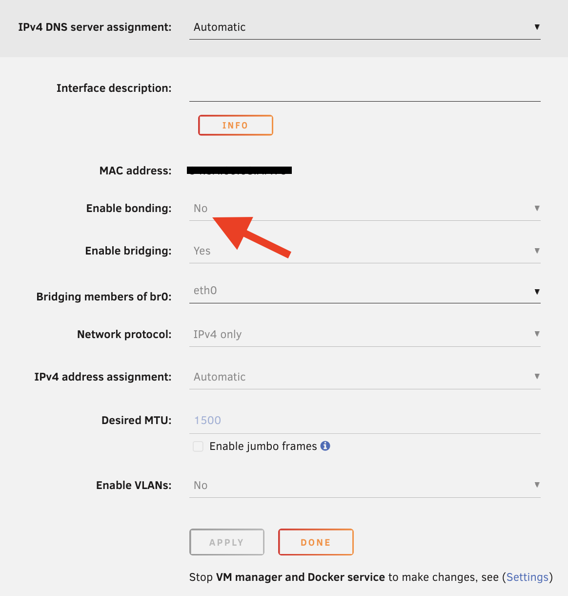

Hi @JorgeB
Please find attached:
  • the diagnostic data from dataserver.
  • screenshot of intermittent ping drops
  • screenshot of network settings with bonding off
I disabled bonding on the server and it was good for a few days and now the connection has started dropping in and out like before.
Please let me know if you see the same errors, or new errors.
