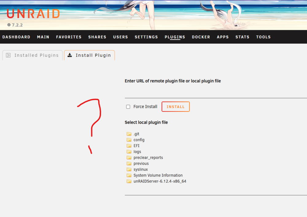

Unraid 7.2.2 "Install" in App Tab doesn't work when REinstalling Community Applications
After updating from unraid 7.1.3 to 7.2.2, I found my CA apps And the CA itself too out-dated to work well.
Tried Clicking on the YELLOW Update info bar hoving above the browser, that would make it turn RED, however no update process window popping up.
Then I tried REMOVING the Community Applications Plugin in the Plugins Tab.

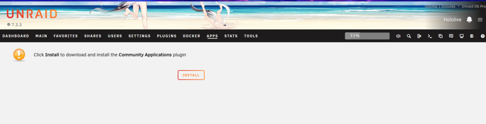

Now there's a brand new installation guide here just like whats on the DOCUMENTS of the CA .
However nothing happens when I click on that "Install" button, no notifications, no update process windows.
Any way I can forcely install the CA Plugin?

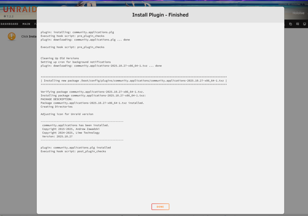

I saw a hoving Unassigned Devices Plugin update Notification when in Main Tab.
I clicked on it, and a window pops up, waited till it finish.
Then I tried the "Install" button in App Tab to install CA.
Guess what, it works! Seems there has been some background task that conflicting with the installation or something?
