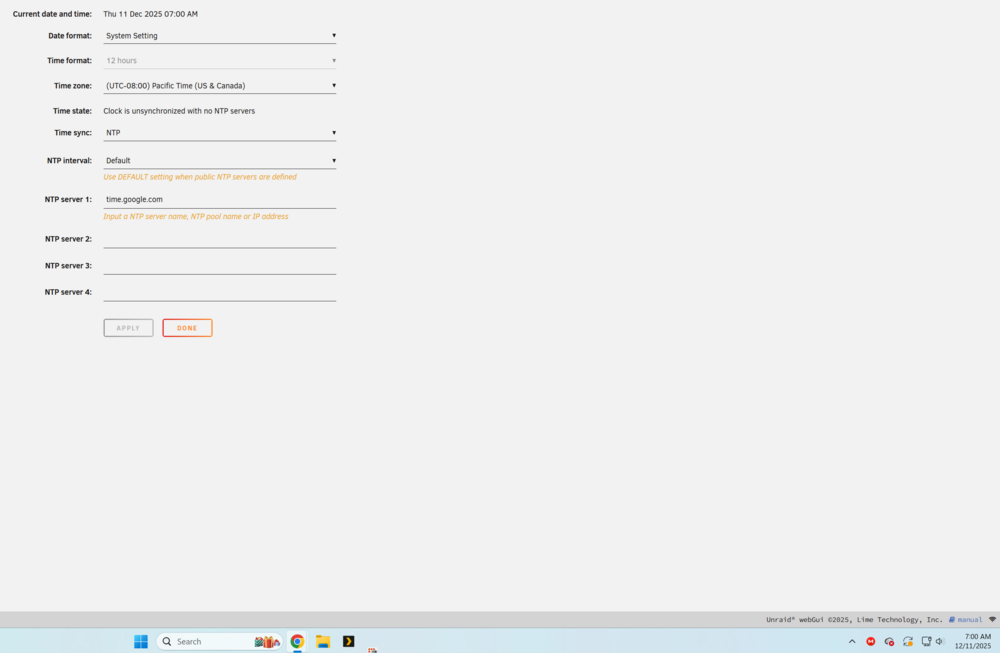

I went into bios and made sure that my clock was correct and did the same within unraid. I did get the email from unraid with the trial key info. I probably have another key linked to this email if it matters.

Check that the date and time are correctly set.
I checked the bios and within the unraid ui and its correct. I'll fire it back up and check again.
Edit: Confirmed to be correct on the unraid ui

If the date/time are correct and it still fails, it's best to contact support; they can check if the GUID is valid or has been used before.
