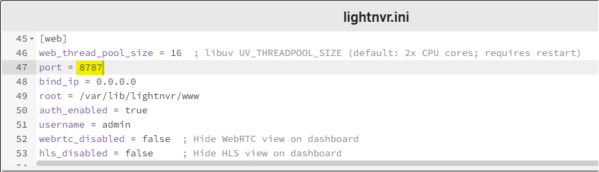

Same issue here with the Web port not working after initial setup. I had to change the value in the lightnvr.ini file and then it worked.
In my case I set it to 8787 because port 8080 was already taken by another app.
