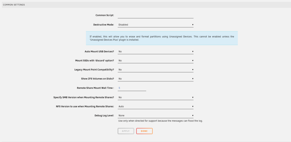

December 23, 2025Dec 23 18 hours ago, bmartino1 said:No UD gives me mount...Again UD does it. Install Unassigned Devices Plus plugin, enable Destructive mode in settings, then you can clear/format, etc... Edited December 23, 2025Dec 23 by Kilrah
December 23, 2025Dec 23 8 hours ago, Kilrah said:Again UD does it. Install Unassigned Devices Plus plugin, enable Destructive mode in settings, then you can clear/format, etc...destructive mode is new to me where is the settign for it Edited December 23, 2025Dec 23 by bmartino1 found it thanks you new testing
