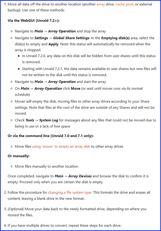

I think the good news is, Unraid appears to now have something built-in that appears to make this conversion easier (or at least I think so). The MIGRATION GUIDE it points to seems a little more straight forward than the directions I was attempting to understand in the past.

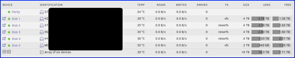

My first question is, "Can I follow this migration guide given the limited amount of space I have on my Unraid Server? Here is a screenshot of the space I have available:
I do have an extra 4TB drive available. Should I maybe switch it out with the 2TB drive first to give me more space?
The migration guide is as follows. If I do have enough space and can follow these steps, can I really not do step 3 and just leave the files where they are once I've completed the format change on all 3 drives?

Solved by JorgeB
Yes, as long as there's enough space to empty one of the reiserfs disks to the other ones at a time, which appears to be the case, as long as you are not excluding disks for some of the shares.
