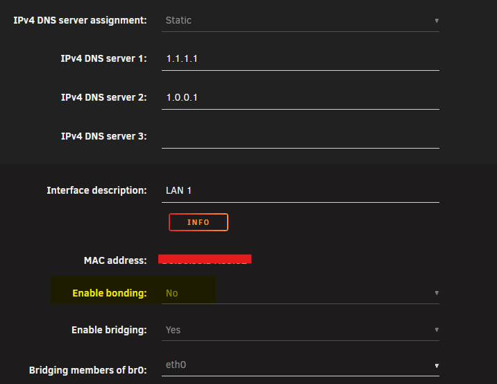

Disable bond in Settings --> Network Settings in the GUI

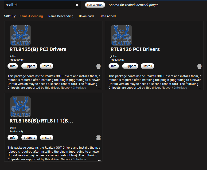

Try Installing the RTL8125(B) drivers plugin from Apps in the Unraid GUI. Then reboot.

@Hoopster I don't have the bonding setting options like you do (see attached picture). I had to lookup "enable bonding" and then the words popped up in setting, but there was nothing for me to choose. Also, being that I don't have internet access, I can't get the plug-in through Apps. I did go to realtek and download the driver. but I can't figure out how to load it manually. Thank

NIC is not supported by the stock kernel driver, you need the Realtek 8125 plugin.

The easiest way is typically booting the flash drive in any other PC that has a supported NIC and using that to install the driver plugin, then put it back on the server.
