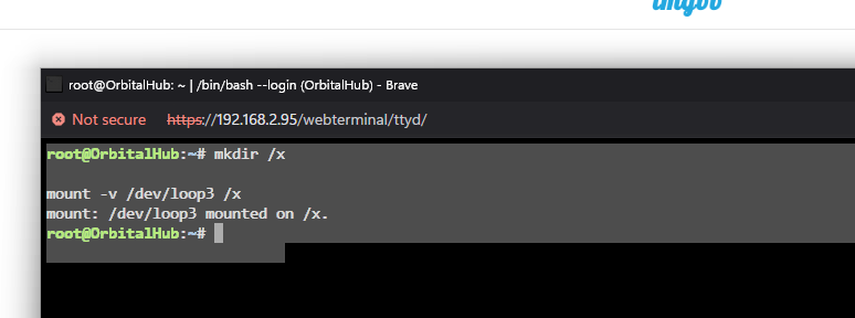

btrfs fi show is not detecting the filesystem; make sure /dev/sdl is still the correct disk, it can change with a reboot, if yes, confirm with a mount attempt:
mkdir /x
mount -v /dev/loop3 /x
If that fails, post the output from:
btrfs-select-super -s 1 /dev/loop3
Filesystem mounted, now post the output from:
btrfs fi usage -T /x
Also browse /x and see if the contents are what you expect.
looks like everything is there, so how do we go about fix it so the array mounts it properly?
