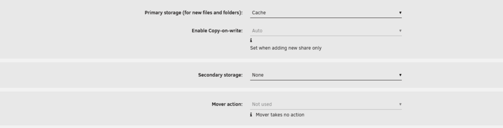

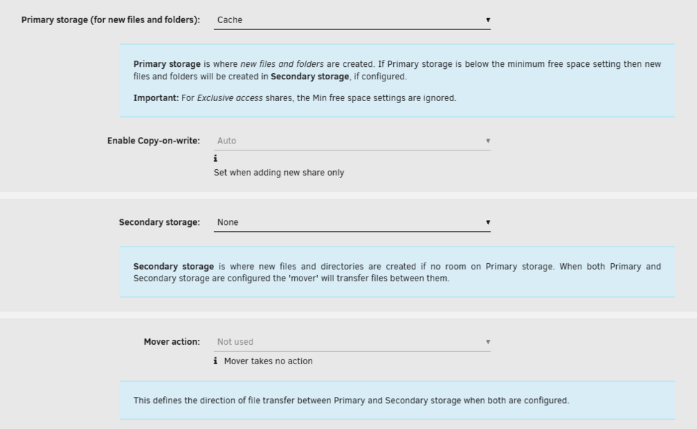

this is kinda curently done with the share settings:
