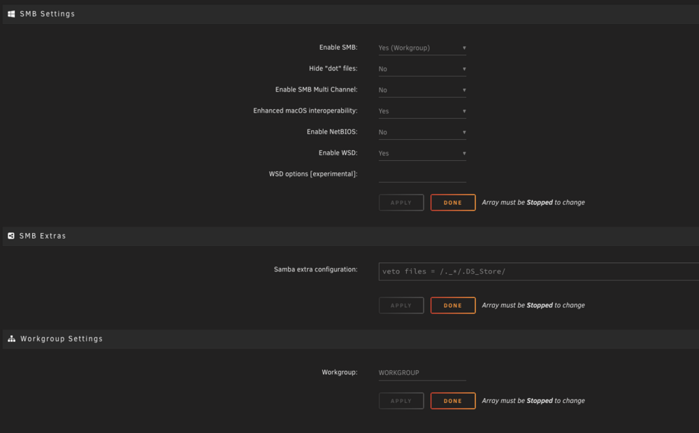

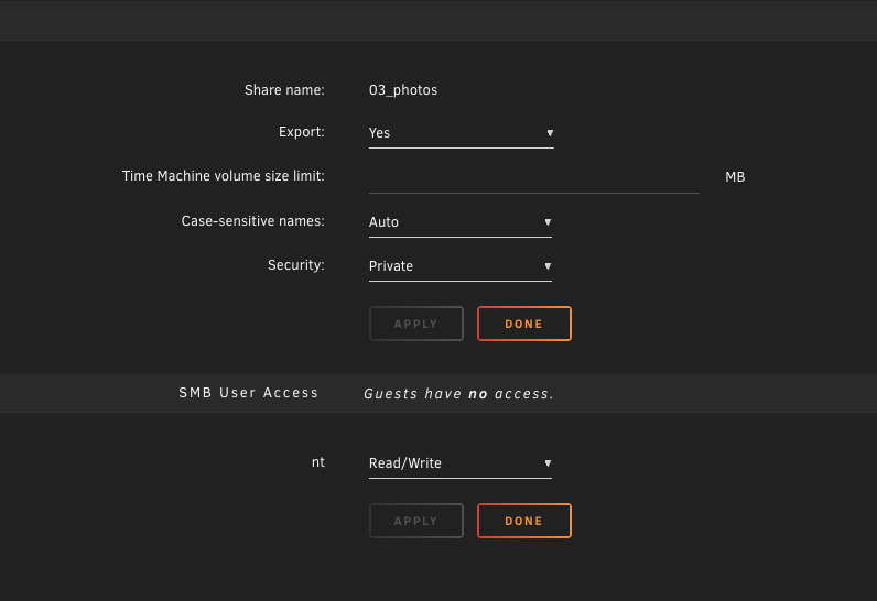

Below are my SMB settings for that share. I have similar problems with other shares
This is my general SMB share settings
Is there some setting that i am missing?

That looks normal, can you copy data to that share from another device, like a Windows PC or even a phone or tablet?
Dear JorgeB,
I was looking around at the shares and I saw that the permissions were wrong. made adjustments and it seems to be working again.
I created the share with ZFSmaster so i believe the permissions were not input properly.
