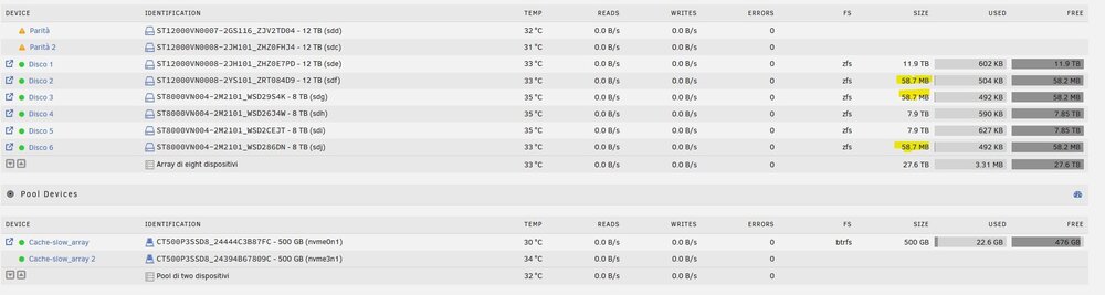

Hi everyone,
I created a new array, but after formatting all the disks, I see that the read capacity on some of them is incorrect.
I tried to format from GUI interface but the result doesn't change.
How can I fix this?

That suggests there are existing small partitions to fix:
Tools - New Config - Keep all - Apply
Then on main, the disks should all have a blue icon; click on the ones that have the small partition and then "ERASE"
Start the array and reformat those disks.

I've followed this exact procedure several times, but nothing has changed.
I thought the problem was related to the ZFS partition (I honestly haven't tried any others).
Did you click the "erase" button? It's not just reformatting...
