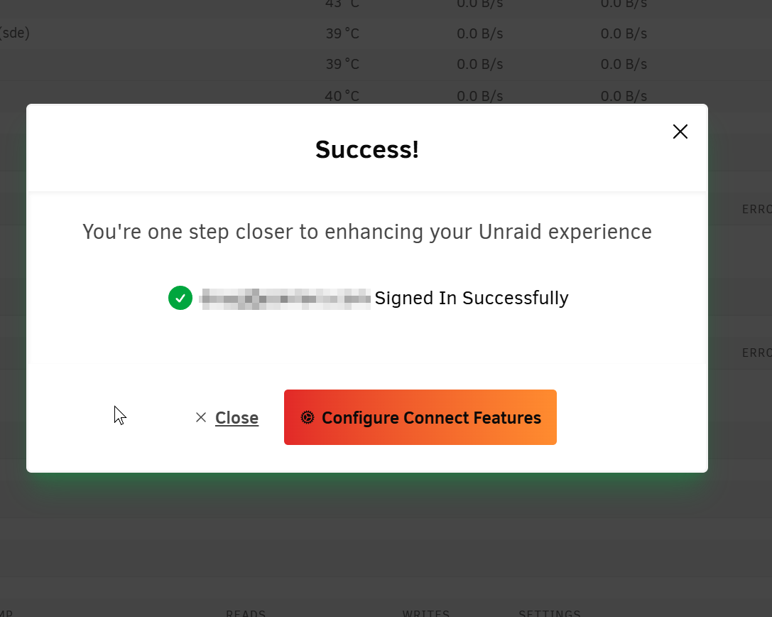

But there is an update to it! And after installing the update from TODAY (19 Dec 2025) it works!
It works with the latest update. Thank you all!
