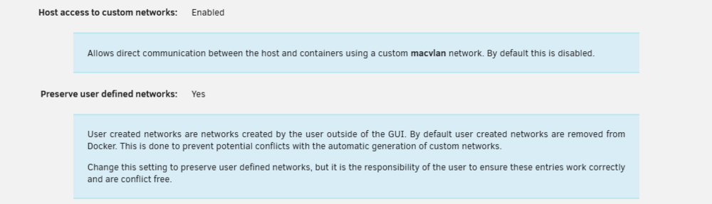

Double-check your docker advance settings.. Make sure host access is enabled

DOCKER Settings:
'Host access to custom networks' was set to 'Disabled' - now changed
'Preserve user defined networks' was set to 'No' - now changed.
Full screen dump of Docker settings below.

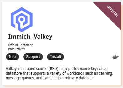

As explained in my guide. updates will break redis and this can and will casue docker instability... Redis is also dead bitnami was bought out and removed this form many repos... the repo that your calling to install redis is no more. You must use valkey... I can't confirm nor recomedn using redis via docker mods for a stable instalations...
please delete teh docker mod and use valkey for redis here is a password protected version
