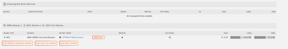

you would setup a share via NFS. and then connect to nfs via UD plugin to have a /mnt/remotes/Hostname_Sharename

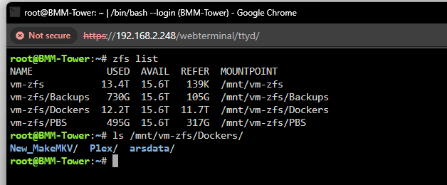

the plex unraid system shares its docker folder:

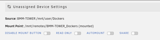

In my other unraid system Via UD in my unraid VM test instance...
and now my OMV unraid instance can interact with teh docker folder...

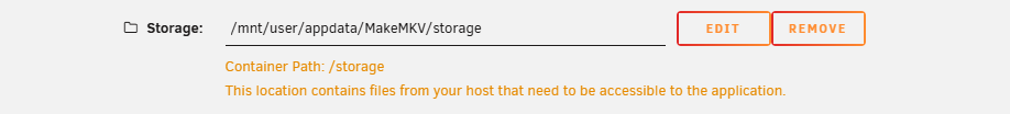

The only share is my "appdarafolder" a Docker folder that contains data for a docker makemkv. As this system is a bit remote. (Tail scale access)
And the docker folder for make MKV so I can rip my own media local at home or in that machine when on site...

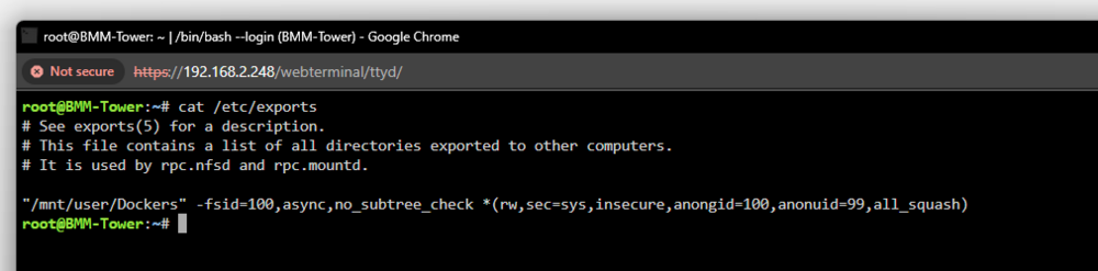

In truth you can use webdav, sftp, smb(samba) nfs any network system via network to share connected between 2 systems. unraid ships with nfs and samba. and for linux to liunx communication, its best to use nfs. This is due to rules and being able to share the folder to a select ip or ip range and be secure while maintaining file integrity, permission and other options...

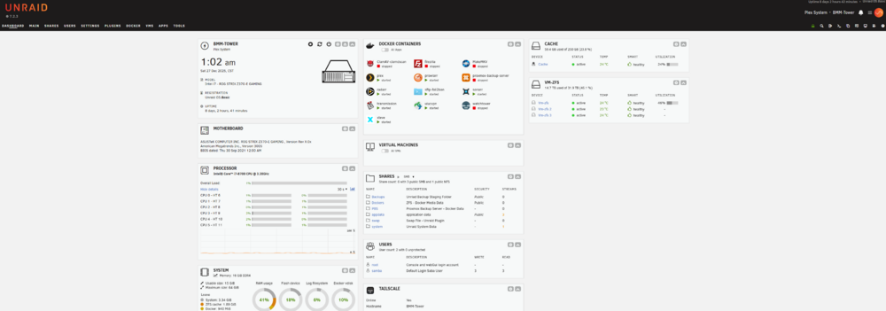

So I have Remote system:
Main job, Plex. I have dockers I want accessible.
I can go to 192.168.x.x and see my system

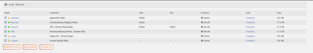

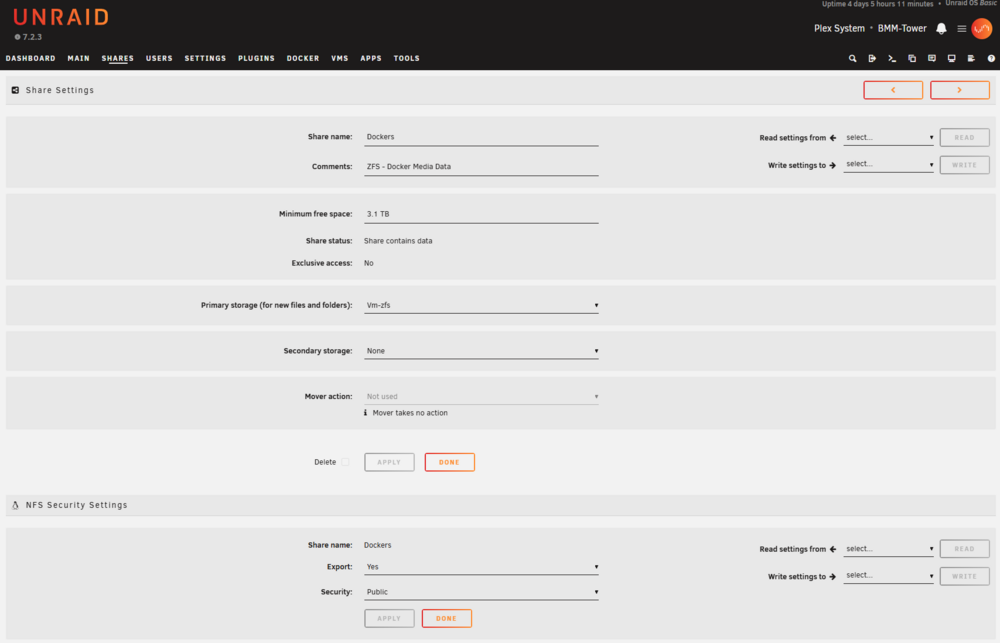

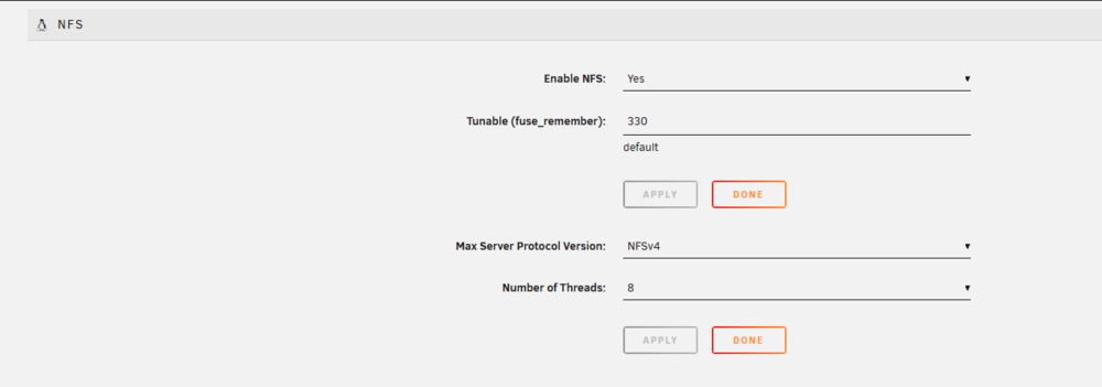

NFS is being wonky (as I have done similar test with v7 beat and RC candidates..) aside, so I recent changed it back to public:*the share would be secure/private and a nfs exports rule would be set....
*as you can see the plex unraid is using this folder share via nfs in public mode...
unraid setting requires nfs enabled for both the server and the UD system to connect...
you can edit the default unraid appdata settings. as mentiond before to share your docker data. If you stay with unraid defaults.
in my case this is ZFS. i have a dataset called Dockers

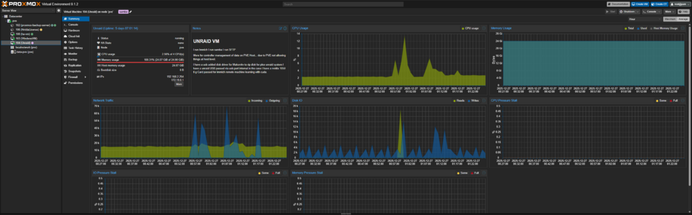

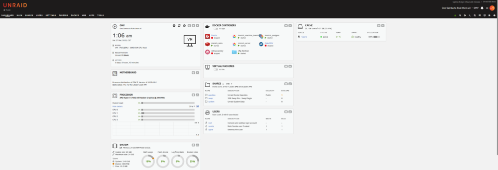

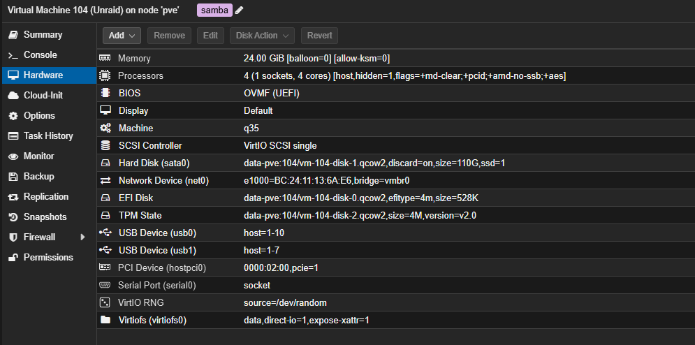

My home machine in a VM:
Thus my home unraid instance...

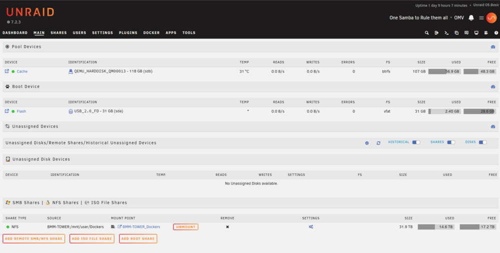

I use unassigned disk and mount my nfs share to be able to talk see and write files

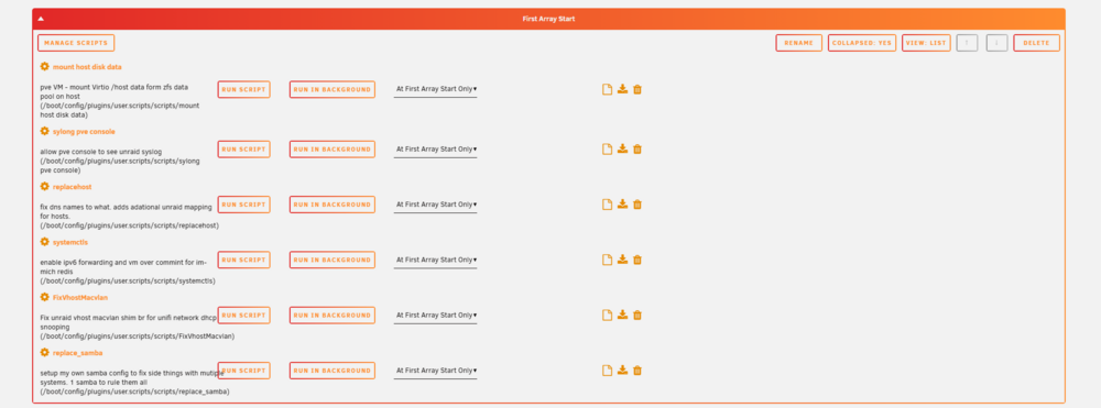

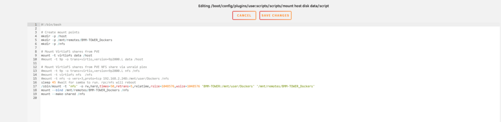

* I actual use a user scirpt. As I was testing nfs, 9p9mode and virtfs with vms... Decided after i got it working to why have another point of failure if proxmox connects first then passes so I moved the nfs connection into my main OMV unraid instance.
I run quite a bit of custom workaround code... (one thing leads to another. but I know my way around the system...)
Normally one would set up and use UD with automount..
*in my case this borked some things and I wanted teh mount else where...

I run the mount command that UD does and rebind it to /nfs ... as I orginal mounted nfs via pve and into the VM by another virtfs.... so my previous data fo mount points for PVE OMV... as Unriad is only geting a qemu Vdisk for dat... PVE is my zfs data pool and control system. But all my data from ZFS is on my PVE instance so SMB mount and others...
*Original was going to use remotes, but nfs pve to unraid and didn't like what the UD makes as it generates treible name paths... UD mounts these at "/mnt/remotes" and that is not easy to type and use when in testing... so for quick writes as I have issues with keybaords and buttons :/ to help with quick writes where I can now use "/nfs" when refering to my plex stuff on another system...
so I took control and ran a workaround to make it do What I want it to do and How I want to interact with it...
so now I can interact with /nfs as if I was on the Plex OMV server, but I'm on my OMV instance using NFS.

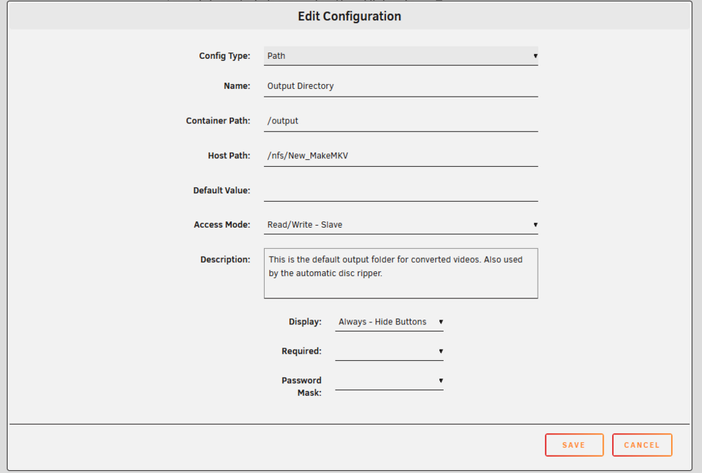

so what about the docker! so now my docker needs sahred mount spaces
OMV:
I can mount map and set this to use the nfs share path /nfs. FCP checks and fixes these things (atleast warns that hey you should do this because this...) as I'm using a remote folder for a docker and due to unraid "Fuse" for making and mount things at /mnt/user ... I need to set a "slave" read/write in the docker settings in the event of network failure nd the nfs connection is down where OMV can't talk to my plex unraid instance...
And this is why I said what I said and why i'm doing what i'm doing in this current refactor.
this allows me to use the same docker at home or remote to interact with 2 separate systems. Bare-metal and VM betwwen 2 unraid instances and dockers.
