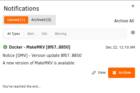

I could see a user script pulling the archived / saved notify messages, the data that would get piped to syslog.
If I'm understanding you, you want the syslog to also show a unraid notification and its data in the syslog itself:
After tracking it down... as a reboot clears theses notfications...
Unraid has a emhttp monitor script and ini files that runs the notfiy script. as we can leverag the notfication scrip tto make a unraid notficaiton... It was then track down where notify saves the unread and archived messages..

So, I will have to re dig at the docs as the agents and system was reworked a bit.
as theses are saved until a reboot and I dont' see why they couldn't be also apedend or sent to syslog. More trying to remover the path where the txt files are saved.
If i'm understanding your corectly now. as I could see a use case for this especial when diag and a syslog server is running to capture data...
But a user script can be leveraged to move the unread items into syslog and put them in archive...

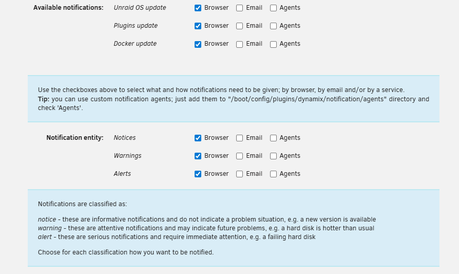

/boot/config/plugins/dynamix/notifications/agents/syslog.sh

To make a agent ...
per squid example work flow:
https://github.com/Squidly271/Wxwork-sample
data per squid:
https://docs.unraid.net/unraid-os/release-notes/7.0.0/#notification-agents
as I think jsut makeing hte script here will auto run with teh agents check marks... I would have to tes this and report back...
The simplest solution in the current setup is an alert agent in Unraid itself. And it only requires calling logger with a single command, and would be a checkmarkable agent in the official WebUI.
The code is simple, it's unified, there are no third-party factors or hacks. Just one and done. No monitoring, just an agent that would be called like any other through a simple enabling in the webui.
