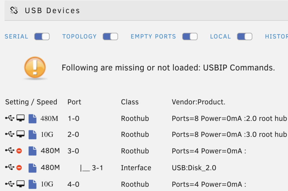

Also noticed that I have a tab "USB", which gives me below info. Maybe that can help lead to the solution?

I'm not sure where that USB screenshot is from, but it doesn't look stock, so you may want to retest with a different flash drive using a stock Unraid install, no key needed, then see if the enclosure is detected to rule out a config/plugin issue.
It is a regular Unraid install. Just using the "USB Manager" plugin. I uninstalled the plugin, but no change. Somehow not identifying the enclosure. Quite weird as the enclosure is being identief on my other Unraid server. Any idea what else I can do to trouble-shoot. Let me try a few other USB ports.

I can see below under "system devices". Is this my disk? If so, any idea why it doesn't show under UD?
IOMMU group 32: [1022:149c] 0a:00.3 USB controller: Advanced Micro Devices, Inc. [AMD] Matisse USB 3.0 Host Controller
Bus 003 Device 001 Port 3-0 ID 1d6b:0002 Linux Foundation 2.0 root hub
Bus 003 Device 002 Port 3-1 ID 346d:5678 USB Disk 2.0
Bus 004 Device 001 Port 4-0 ID 1d6b:0003 Linux Foundation 3.0 root hub
This should be the flash drive, post the more verbose lsusb -vt output
