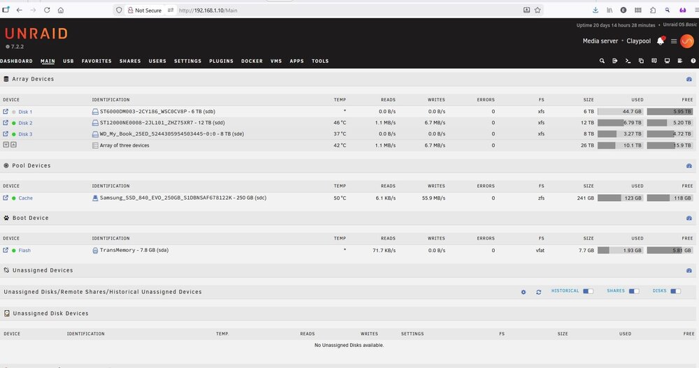

Below is a screenshot of how my array used to look. I recently added Disk 3 and moved all the data from Disk 1 to this new drive. Before adding Disk 3, I ran preclear to test it since it was brand new. I did not notice any issues with it, except that I could not get it to spin down, even when pressing the green button next to it with all VMs and Dockers shut down.
I do not remember exactly what happened next. I created a new config, removed Disk 1 and started a preclear on that drive, which I later stopped to continue at another time.

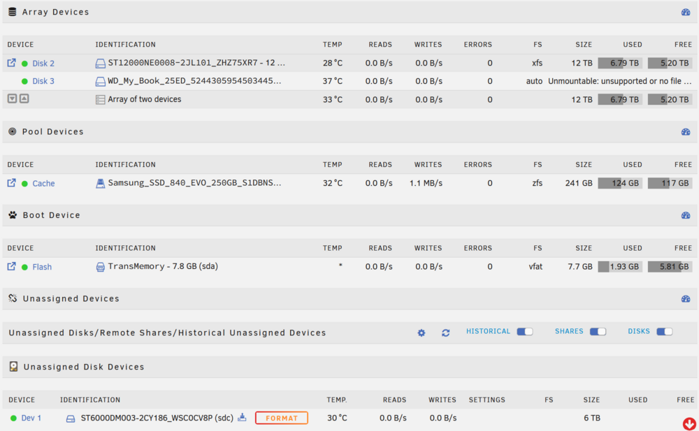

At some point I noticed that Disk 3 had changed its filesystem from xfs to auto, with the additional text "Unmountable: unsupported or no file system", as seen in the screenshot below.

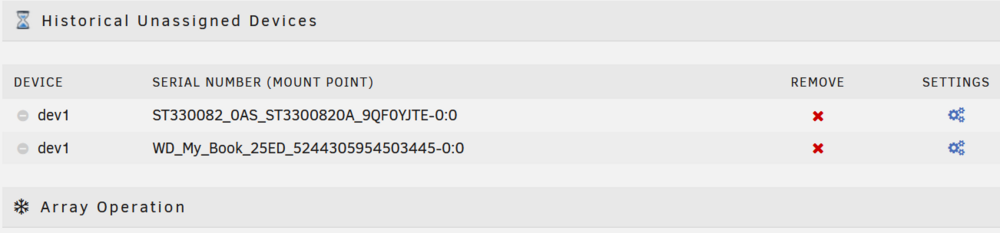

At the same time as Disk 3 is listed in the started array, it also appears in "Historical Unassigned Devices".

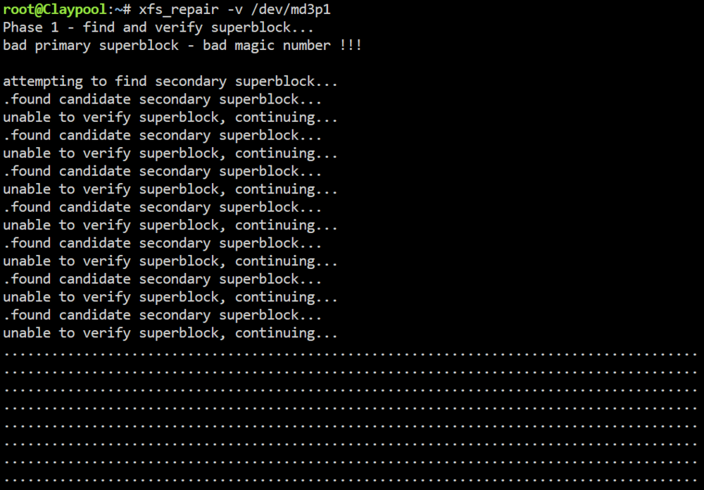

I restarted the array in maintenance mode and run xfs_repair with the command 'xfs_repair -v /dev/md3p1'.
The result can be seen below, it has printed dots for an hour and I am not sure for how long this should go on.
