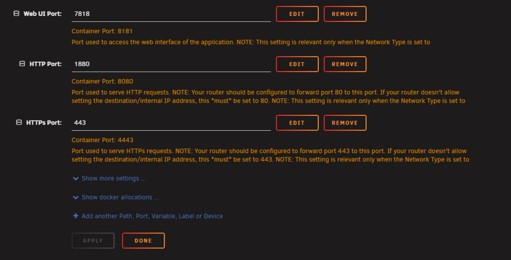

How should i configure the NGINX docker app in unraid and which port forwarding should i do in my Unifi Router (USG PRO 4) to allow NGINX to 'see' my home assitant yellow on the different VLAN.
FYI, below are currently my configuration settings for the NginxProxyManager container.

With help from the Home Assistant Community i got to the point that:
i created a DNS A record for ha.mydomain.com pointing to my unraid server's Tailscale IP. (hence same as for server.mydomain.com).
In NGINXProxymanager I created a proxy host pointing to http:[myhomeassistanyellowIP]:8123 , i also created a SSL certificate.
however when i surf to ha.mydomain.com, i do not land on the home assistant landing page, but on my unraid's server landing page.
Should i somehow use the IP address of the NGINXProxyManager container instead of my server, or why am i not redirected?
