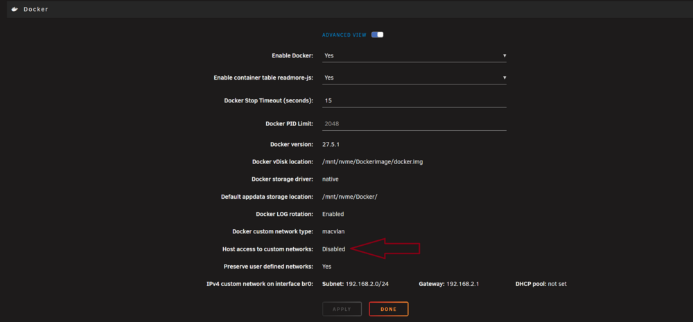

I am running Nginx Proxy Manager via a Br0.80 interface. So it is running on VLAN 80, with an IP address of 192.168.80.50. It is all setup a working great for several other Br0.80 services, as VLAN 80 is my DMZ.
I am trying to setup a few 'LAN only' proxies so I can access local resources using domain names instead of IP addresses. I was able to add several other Br0.VLAN services just fine. However the issue is any service that is running in bridge mode (using the same IP address as my unRAID server) will not work. I cannot even curl the sites from the Nginx Proxy Manager.
It seems like something in the unRAID docker engine is blocking me from being able to access the unRAID host IP address.
Have you enabled this setting in Settings-Docker?
I have not, but I didn't think it applies?
If you look at the help it is for macvlans, but I am using ipvlans.
Regardless, it looks like it could be the issue and the help is just incorrect?
Enable the "Host access to custom networks:" option and it should work. I had the same problem when i started with Unraid and with npm and it would get me only a 502 Bad Gateway Error when i tried to access for example Pihole WebUI running on br0. Use ipvlan (so you don't get an duplicate ip warning from your router) and enable the host access option.
